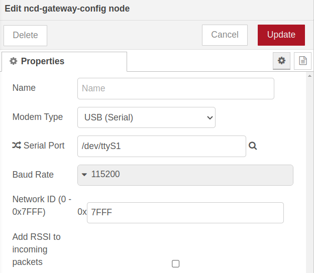

this error is coming from the radio module not able to talk to edge computer.
can you share serial setting ?
Hi @mirko You can access these from the search tab in the top right, then select 'Configuration nodes:
Double-clicking the ncd-gateway-config node will open the serial settings. Could you share a screenshot of this with us? It should look like this:

dear Eduardo i tried to set serial port as your (/dev/ttyS1) and now i get the following:

Hi @mirko Sure, The IoT Edge computer is Linux-based and uses the serial port “/dev/ttyS1” to communicate with the radio module, rather than a COM port as in Windows-based systems.
Just to clarify, the IoT Edge computer does not require the Industrial IoT USB Modem to communicate with NCD Sensors, as it already integrates a Radio Frequency Module compatible with your frequency to receive data from NCD sensors.
