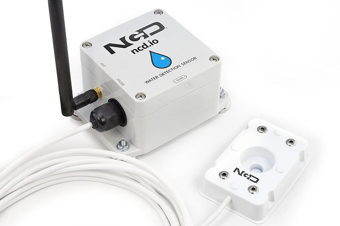

I'm trying to set up a water detection sensor
When I try to configure the water sensor and select the sensor type, there is no such device listed
If this is a water detection sensor like this one:
Then it is simply a type 2 2 Channel Push Notification sensor in Node-Red.
