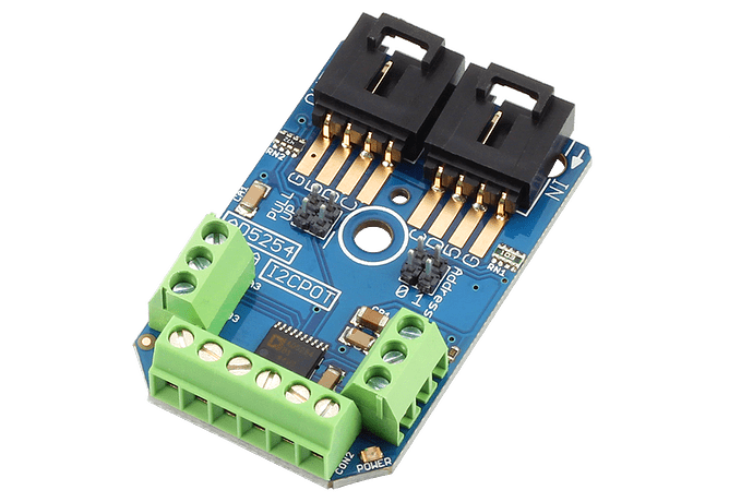

I’m trying to detect devices ( AD5254 Digital Potentiometer over I2C using a serial-to-I2C converter) on the I2C bus using Python (I can do it via AnyI2C GUI application), specifically I want to see if devices with addresses 0x2C and 0x2D are connected. Once detected, I want to send a reset command to the devices. Could you guide me through the process?

I am using 2 of these devices and I2C converter:

I’m using the USB to I2C Converter with Virtual COM Port (FT230X) and it’s working fine. I can send data and receive responses from my AD5254 digital potentiometer devices (addresses 0x44 and 0x45), so I know the USB-I2C adapter is alive and working.
However, I’m not getting any response when I try to use the I2C Bus Scan Command. I saw in the documentation that this command requires Firmware version 6 or later.
My questions are:
  1. How can I check the firmware version of this USB to I2C converter?
  2. Is there another way to scan the I2C bus to detect connected devices, without relying on the scan command?
  3. I would like to perform a soft reset of the AD5254 devices before using them. Will firmware limitations affect that?
