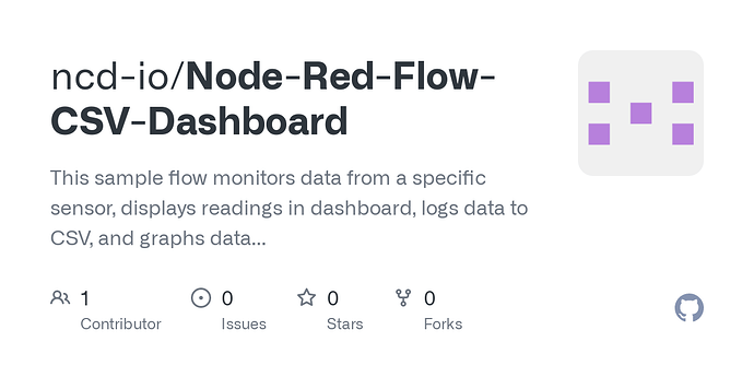

I am using node red on linux. For my application every 5 minutes the sensor does an acquisition. But the data ( vibration along x,y and z axis) are only available in the command window where I am using node red. So I want to recover these data in a file preferly a csv file.
You can implement a Node-Red flow that will log readings to a CSV file. We have a CSV example flow here:
You may need to adapt it to your particular use case.
