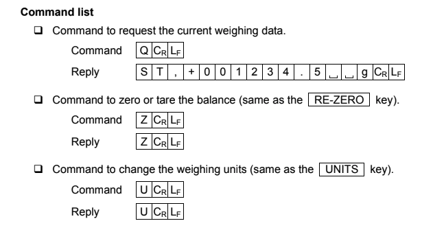

My customer has an industrial scale that communicates with external systems via a RS232 port. To obtain the weight measured by the scale, a command is sent to the scale controller via rs 232, then the scale sends us the measured weight as a response (see diagram).

I would like to be able to poll a scale to get the information on a period basis vs. it reading on a continuous basis. this is to control the volume of data transmissions.
i.e. send a print meessage to the scale to get the values.

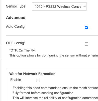

Hi @danempiric you can configure the NCD RS232 Device using the Wireless Device node (baud rate, stop bit, parity, etc). Then you can use this flow to transmit a RS232 command in Hex to request.

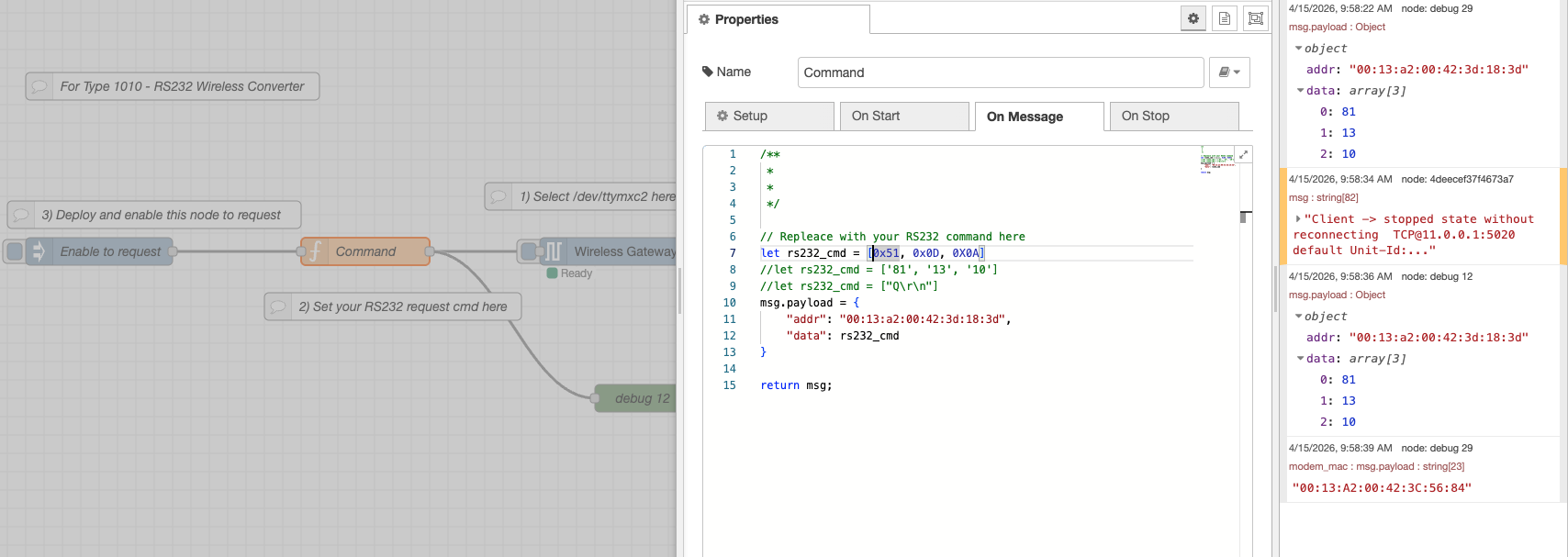

Hi @Eduardo_Mtz
I used the following flow provided but it doesn’t seem to request the values from the device. I lined out the wires so those should be fine. Unless there’s a better way to troubleshoot the issue.
I am trying to send Q CR LF

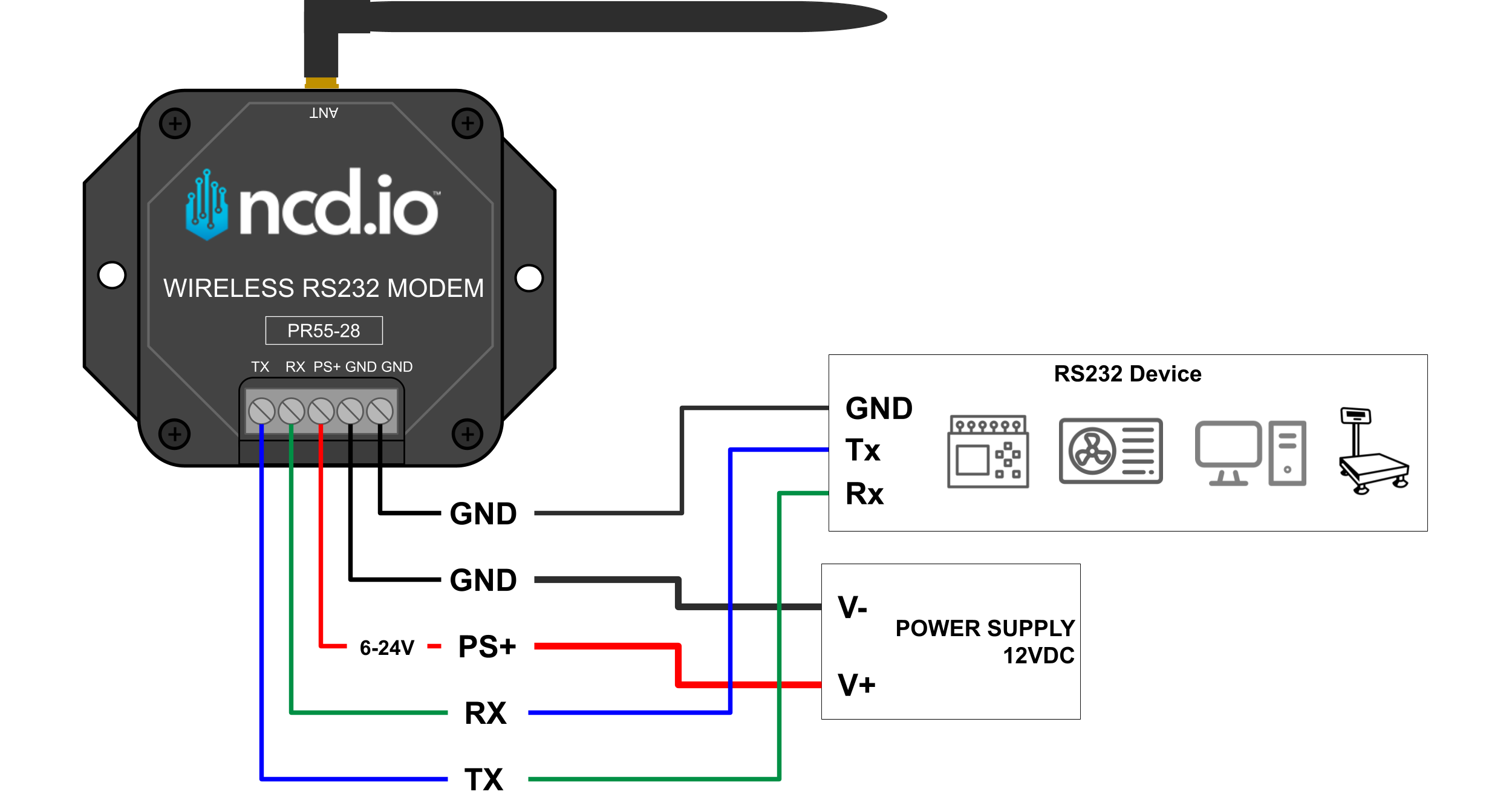

Wiring Diagram:
