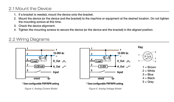

Does this laser sensor has connections for external power supply or its a true 2 wire sensor.
No the laser has 3 wires, power, ground, and data (this is what transmits the 4-20mA current)
It actually has 4 wires, the black one is for data in, but I am not using this one.
it wont work with the board you have and might have fired it as well.
the ADS board also provides loop power and so does your sensor. both power supply will try to over power each other.

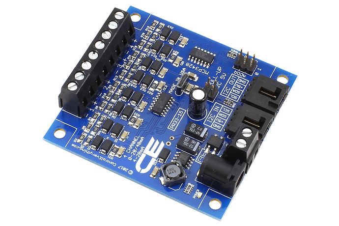

You need this board
