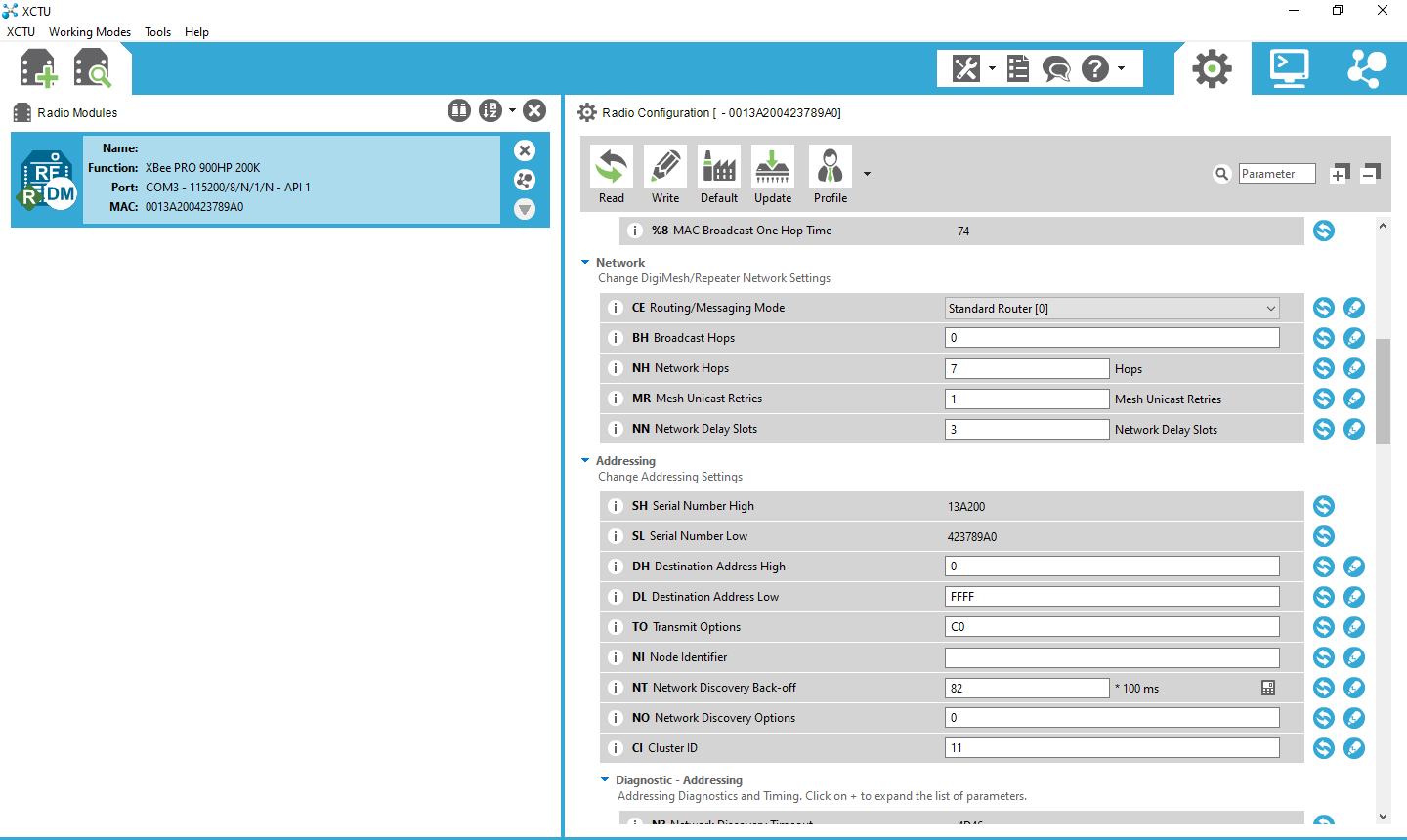

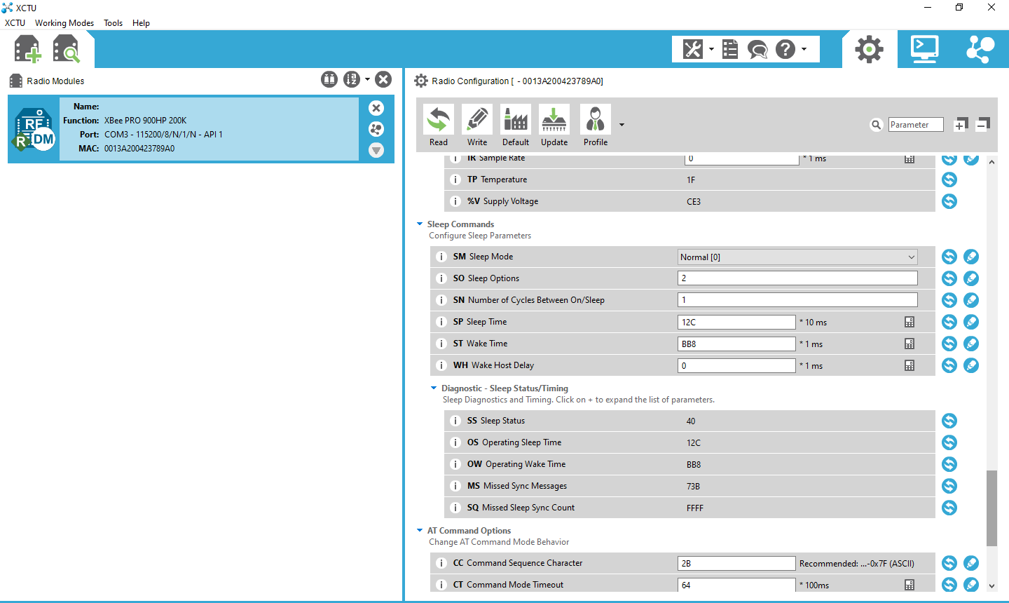

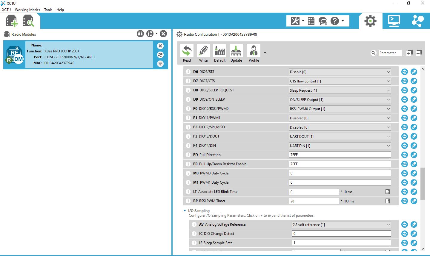

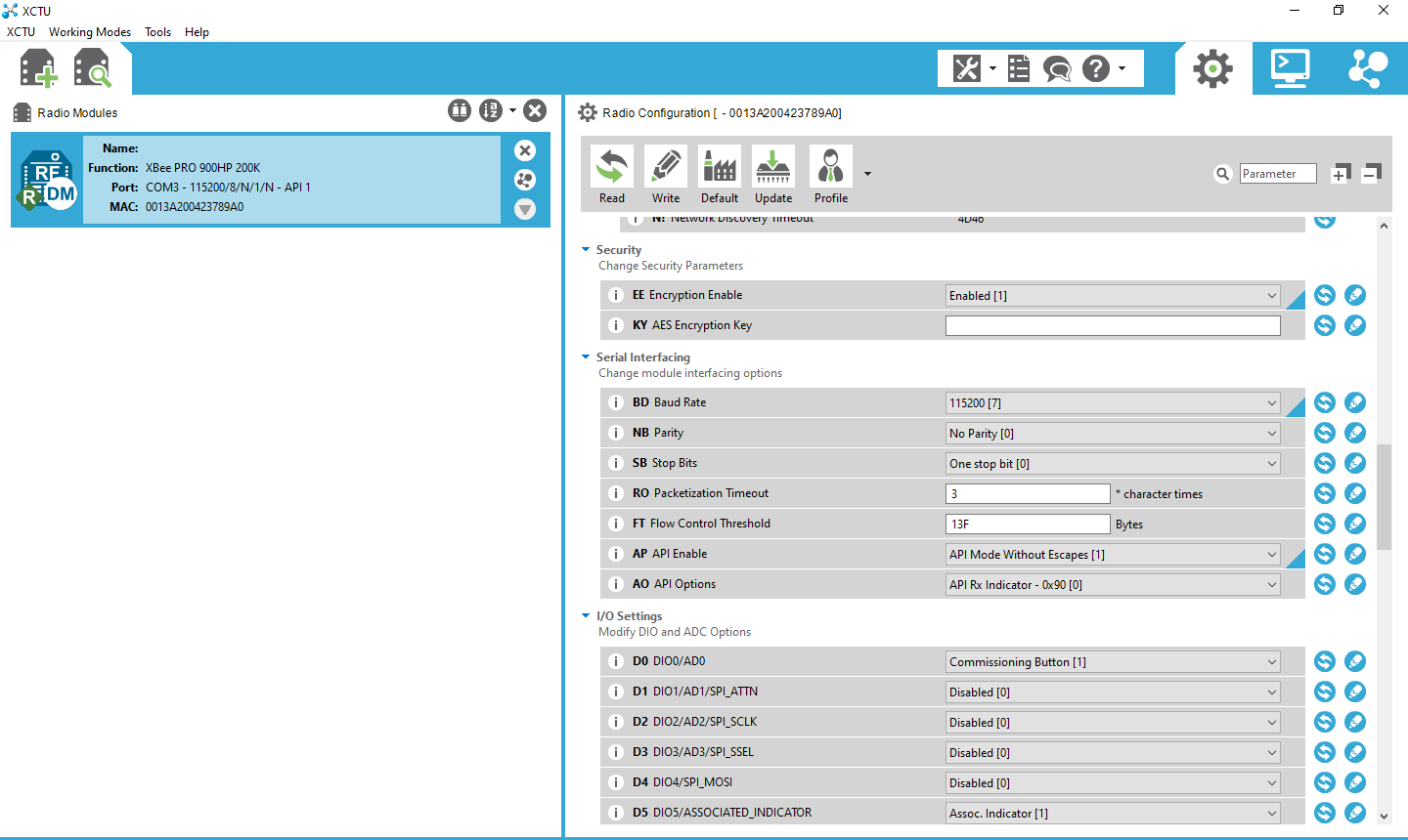

I switched the modem to USB mode and this time I was able to use XCTU to successfully reload the profile as described in the link provided above. Still neither Alpha station nor Beta station will communicate with the modem via USB, even though XCTU has no problems connecting immediately with the same settings.

can you share the screenshot of the xctu ?
