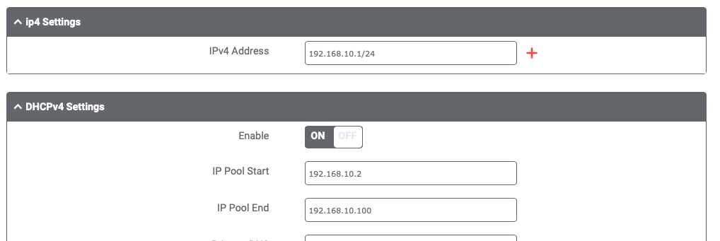

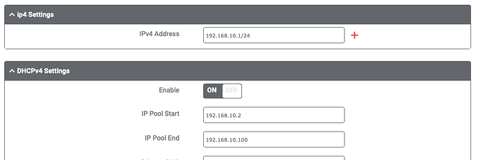

Go into the Configuration Dashboard (Port 80) and on the left go to Network > LAN. On this screen click the edit icon next to LAN1. On the modal that pops up change IPv4 Address, IP Pool Start, and IP Pool End subnets to something like 192.168.10.x like in the attached screenshot. Once done click Submit and then the red checkmark at the top of the page.
Let me know if that stabilizes the Gateway’s connection.
**edit bear in mind that changing this setting will change the default IP address of the Gateway when you directly connect to it over ETH1 or WiFi
That Worked. The connection is stable now. Thanks for your help
