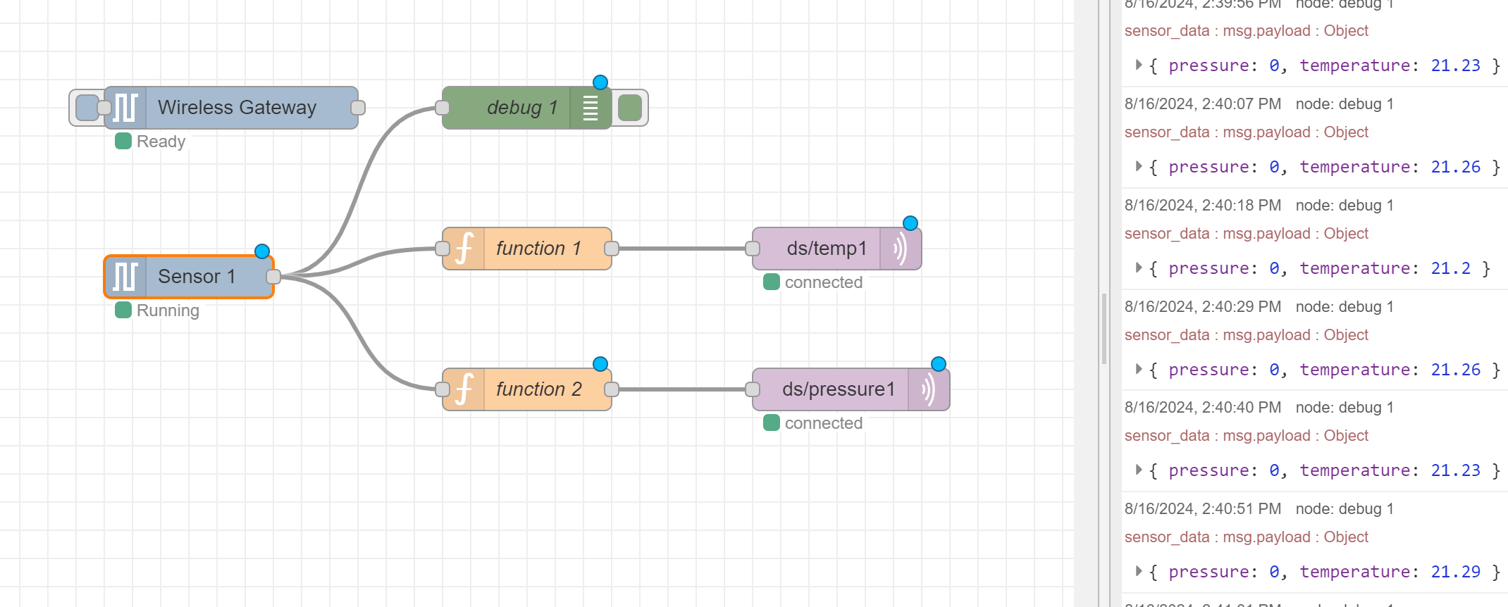

It looks like there are undeployed changes on your flow.
Is this screen capture of Node-Red from when the gateway is connected over Cellular? If you restart the gateway while its not connected to internet over ETH0 do the MQTT nodes still show connected?

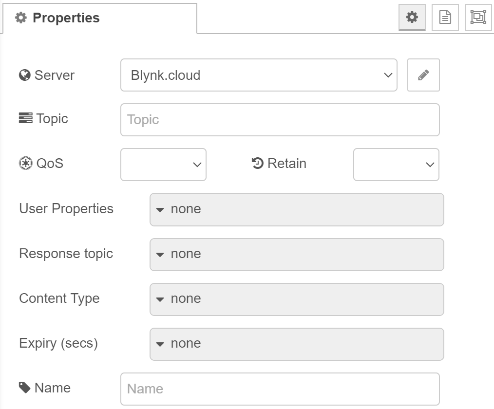

On the MQTT nodes what is the QoS set to?

Ignore the undeployed changes. That was simply when I took the screen shot.
Yes, the MQTT nodes show connected on both ethernet and LTE

MQTT QoS dropdown is blank.
Try setting that to 1 and see if that resolves your issue.
I’m not sure what blank will default to, but a value of 1 will expect a response when data is sent and should trigger a reconnect. I’m guessing that the network switch causes a dropped connection, but with a value of blank the MQTT doesn’t do any integrity checks.

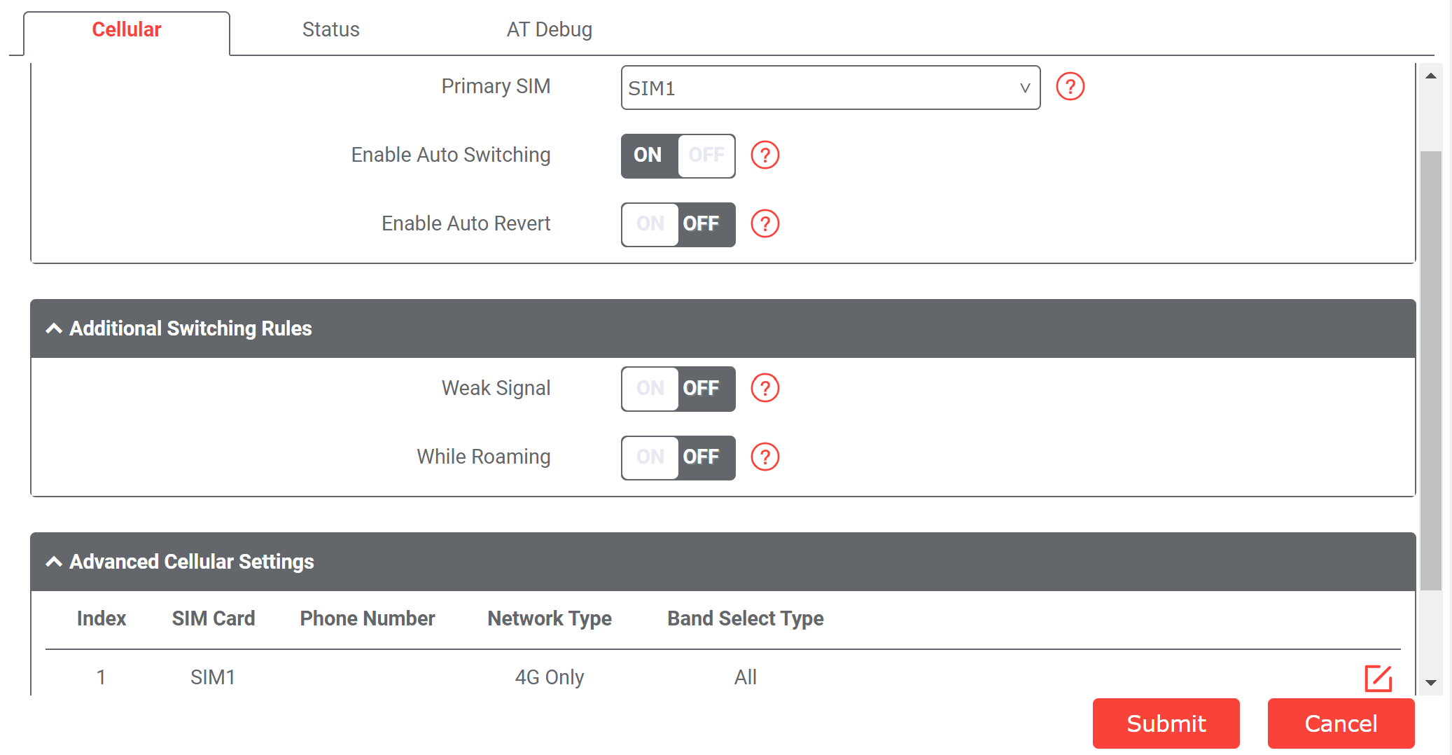

Can you send a screenshot of your cellular configuration? You can find it through the Network Management UI > Interface > Cellular as well as its status (tab along the top of that page)?
These pages should look similar to this (minus the sim not connected message):
