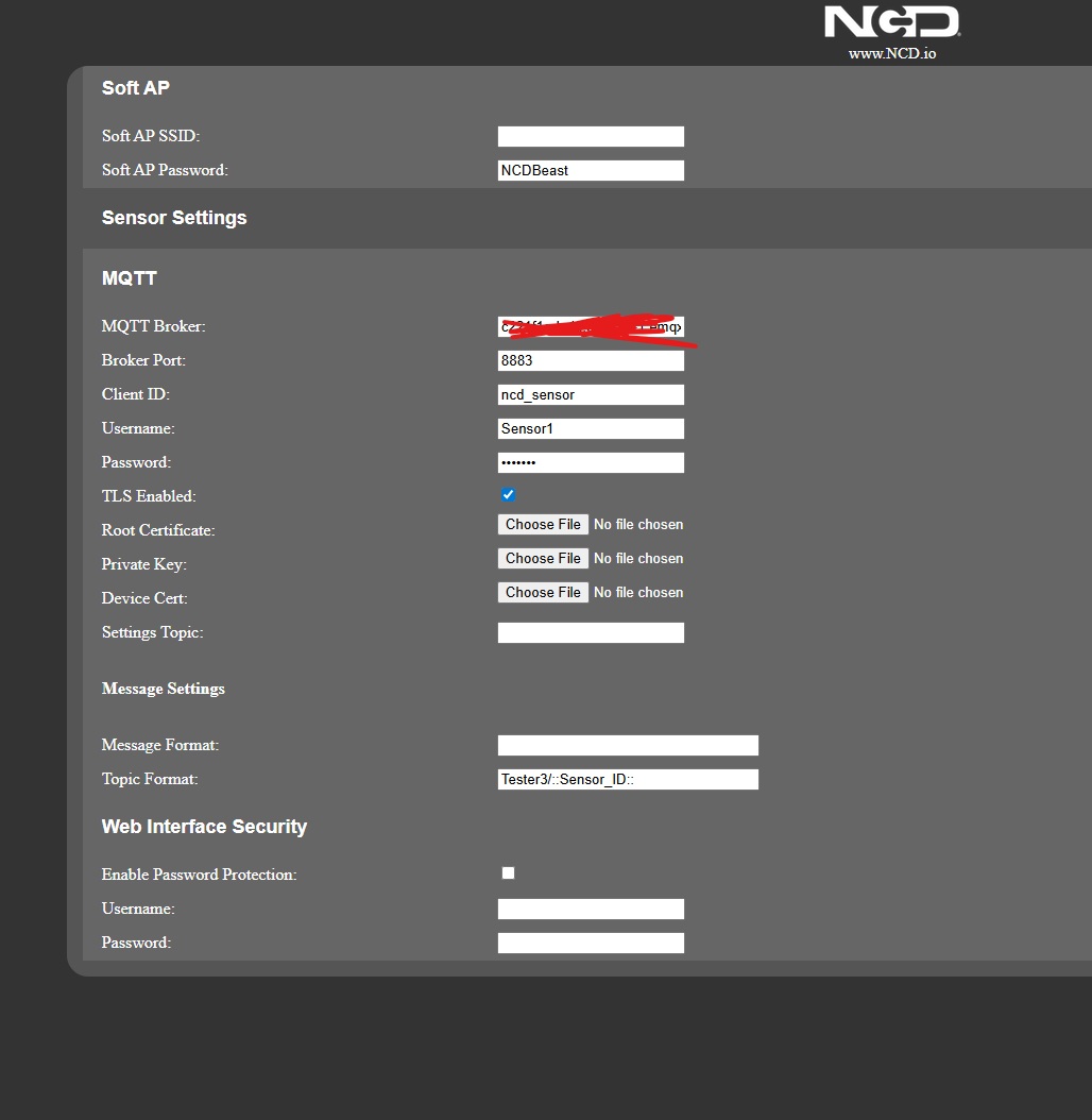

Would you be able to provide screen shots of the settings you have entered in the sensor? Specifically the Sensor data and topic format fields?

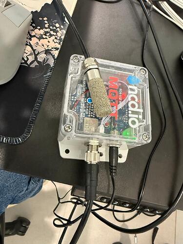

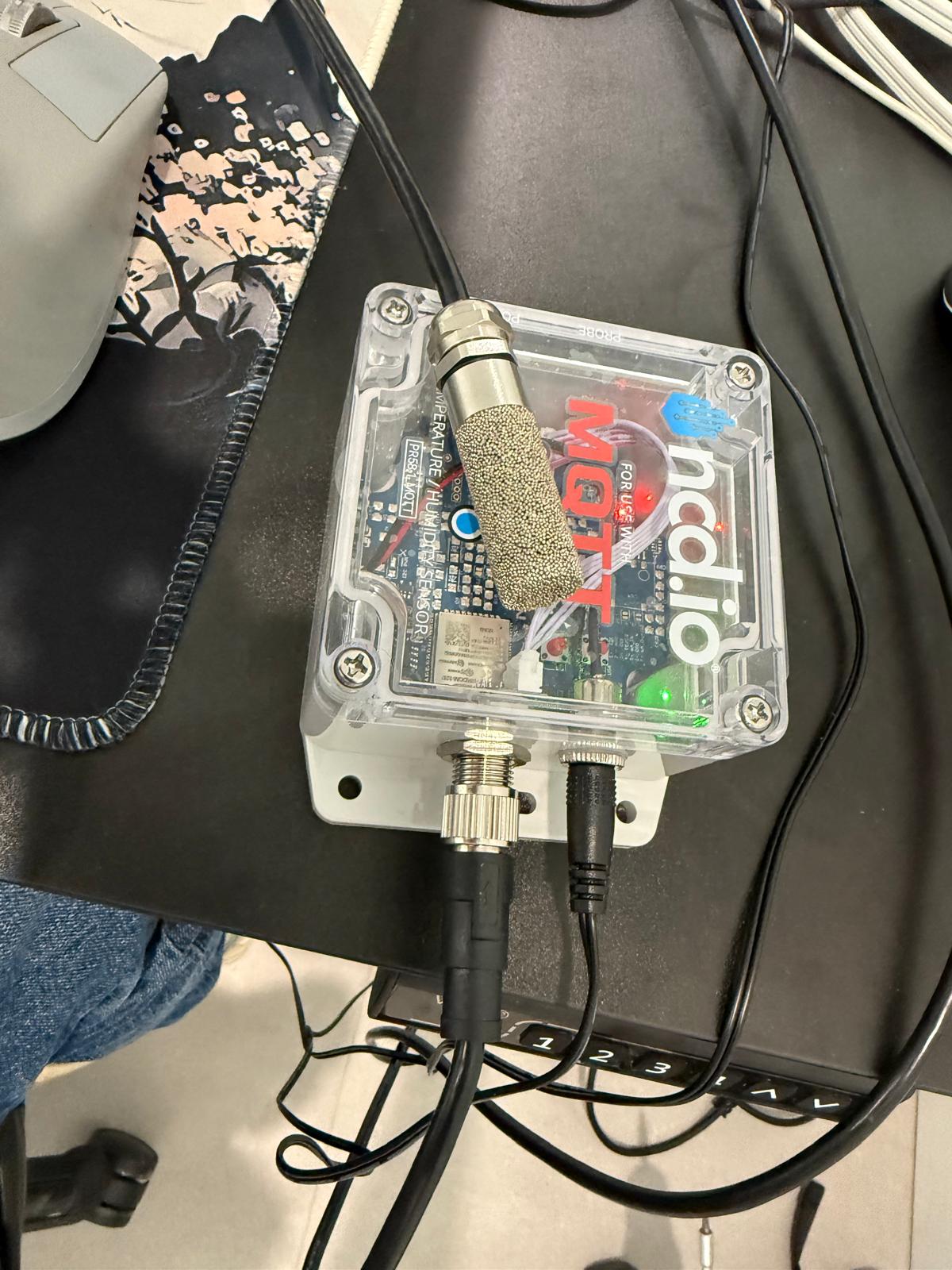

Also can you provide photos of the device powered up?

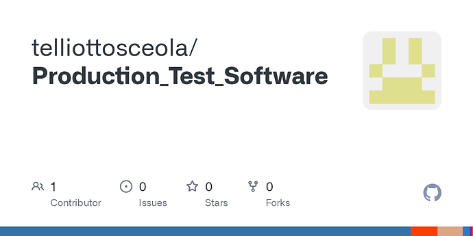

After the board is connected to the computer and mounts as a virtual COM or Serial port you can download and install our firmware flash software here:
After launching the software select the COM or Serial port from the drop down menu, then click the flash button. After flashing completes you will need to factory reset. Note that the test function here will not work for you as it defaults to our wifi network here for testing purposes. You will need to configure after factory reset.

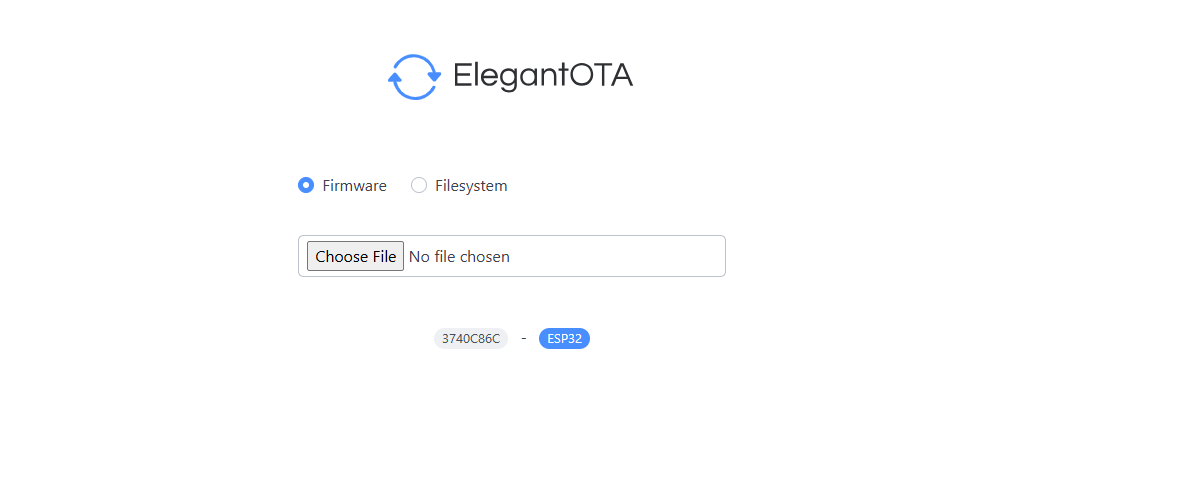

Cant i just update via the web interface?
Updating the firmware via the HTTP/Update worked
