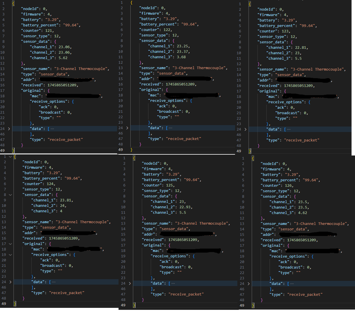

I was looking in the database and saw there are many instances where there are several data samples with the same received timestamp. I know this data is not all the same timestamp. The values (the temperatures) are different, the counter is different. I have included a screenshot of one of these instances where I had 6 measurements at the same timestamp when it should not have been. I have marked out the mac address, but they all have the same mac.
My question is if there are any known bugs where this is occurring.

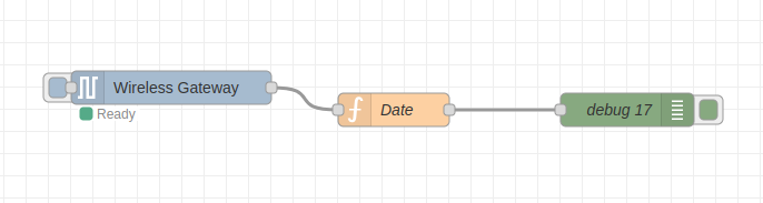

Hi @duelingcats I’ve tested locally and I’m not able to replicate the issue. Could you perform the following test? Try adding the following function node and connect it between the output of the Wireless Gateway node and the input of your HTTP node. Please also add a debug node at the output of the Date function node so we can observe the data locally. To do this, copy the attached JSON file, then go to Node-RED, click on the main menu, select the Import option, paste the code, and click on Import. Finally, connect the node (I’ve attached a screenshot as a reference).
[{"id":"dab10d017d9624dd","type":"function","z":"a4bb3d983476c4ba","name":"Date","func":"msg.payload.received = Date.now();\nreturn msg;","outputs":1,"timeout":0,"noerr":0,"initialize":"","finalize":"","libs":[],"x":630,"y":440,"wires":[[]]}]
Please try this and could you share a screenshot of debug windows.

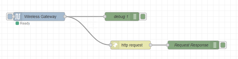

Here is my flow I have that I encountered the issue. As you can see it is pretty basic and nothing really stands out why it would have duplicate timestamps. I’ll report back later if I find duplicate data again.
Hi @duelingcats Sure, yes, it is quite strange. The Function node simply allows us to verify if the Date.now() method is working correctly and returning the proper timestamp. Let me ask you, are you using a USB Modem connected to a Windows machine, or an Enterprise IIoT Gateway?

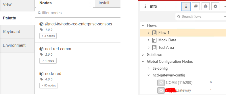

Can you check which of our libraries you have installed and which version of it? There is an older bug that duplicated serial port event emitters on older versions of ncd-red-wireless and @ncd-io/node-red-enterprise-sensors when a flow is re-deployed repeatedly.
Can you also check your configuration nodes in Node-Red to look for duplicate serial ports? Having multiple instances of a serial port can cause erratic behavior
@jacob I am using node-red-enterprise-sensors v 1.0.9. I looked for duplicate serial ports and didn’t see any. I have one for COM8, but is unused and nothing is communicating on that port. That node isn’t placed either. The other one with the name marked in red is COM3 and has the NCD gateway communicating on it. There is only 1 flow with that node and only 1 instance of that node in that flow as you saw in my screenshot earlier.
