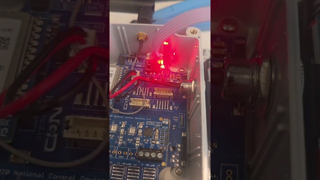

I have 2 devices with same pattern of blinking, 2 times very fast and then 5 seconds of silence then another double blink.
I verified connection to be zigbee board, and even swapped for new zigbee board. no luck at all.
What else can i do to solve this issue?
Thanks in advance

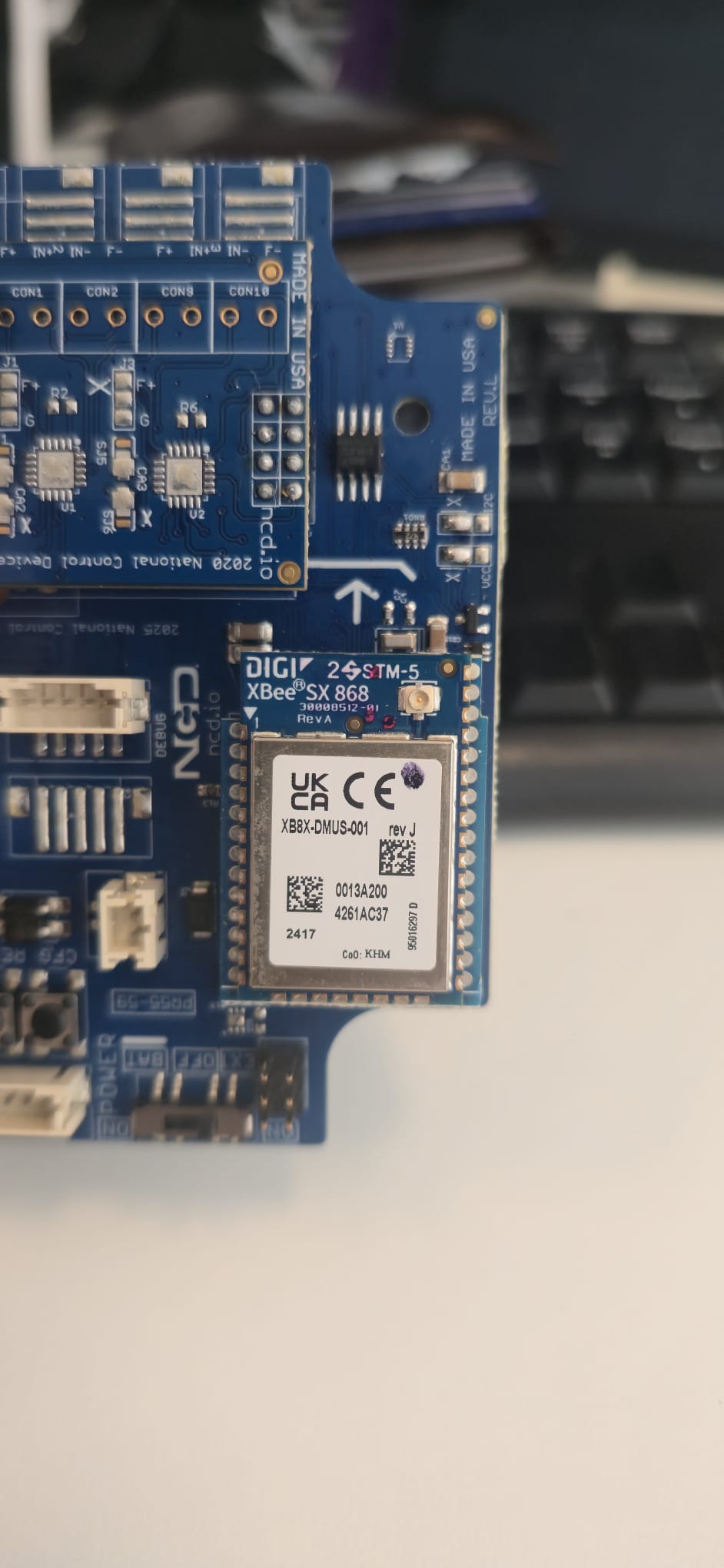

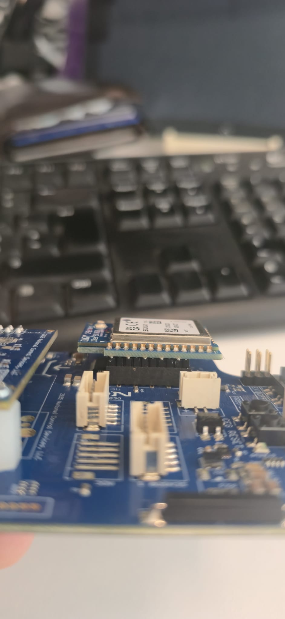

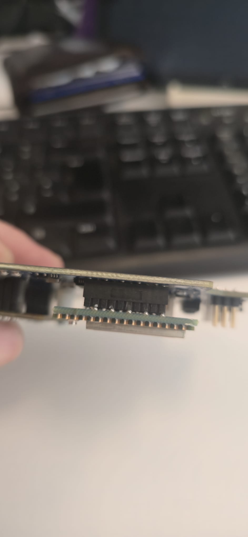

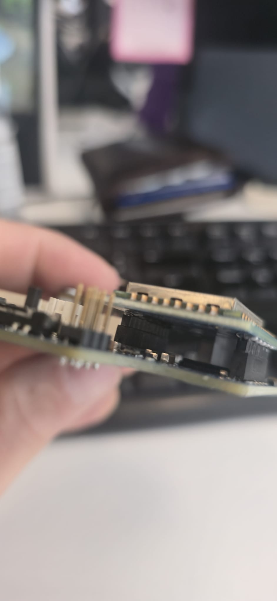

Additionally, could you share a picture of the mounted radio module and its pins?

Hello, Thansk for the help.
Tried other zigbee cards without success, so 100% sure its not the connections.
