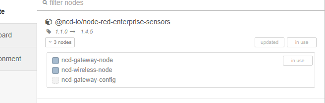

  1. Disable Auto Config: Please check your Wireless Device nodes and ensure Auto config is disabled before you reset the sensor.
  2. Check and Update NCD Library:
  • Check Version: Go to the Node-RED main menu, click Manage palette, and locate the @ncd-io/node-red-enterprise-sensors library to see your current version.
  • Update & Restart: If an update is available, click the Update button. You will then need to restart Node-RED. Please import the attached restart flow into your workspace, click Deploy, and enable the flow to restart Node-RED. Finally, refresh the webpage.
restart-node-red.json (1019 Bytes)
After completing these steps, please try the firmware update procedure again and share your results.

What version of the pallet/ machine uptime firmware should it be on?
I have 1.1 for the pallet which I think has now updated to 1.4.5

Yes try with 42:37:63:0a sensor, please.
What version of the pallet/ machine uptime firmware should it be on? 1.4.5 ncd library is okay.

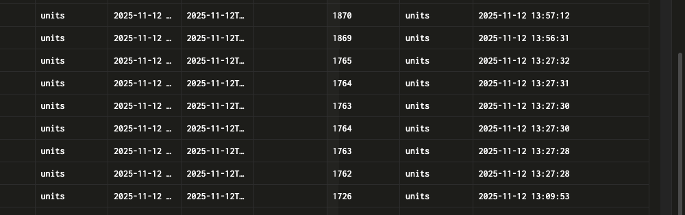

I was able to get the devices to start reading again. But I noticed that it’s not picking up all of the signals. I should be running 100 units/minute but some are getting skipped. It appears that the debounce time doesn’t update will from 50ms to 10ms. Would this be part of the issue? I have tried to update the configuration for the debounce but it doesn’t seem to want to stick.
Ideally I want to see each time it counts. This is an example of the database, for our signals, You can see that it jumps from 1765 to 1869 without any data in between.

Hi @danempiric
  • For your specific application, I would recommend two changes: Increase the Data Transmission Interval and enable the Push Notification setting. Enabling Push Notification ensures that the sensor will immediately transmit data upon detecting a signal change on the specified input(s). When this occurs, the report_type property will be set to 'Interrupt'.
  • Could you please carefully check if the sensor data matches the corresponding values in your database? For example, at the timestamp ‘13:27:28’, the value recorded is 1763, which then increases to 1764. However, the subsequent entry shows 1763 again. This fluctuation (a decrease in an accumulating counter) should not be possible.
Note: It is important to consider that the sensor will transmit a message every time it detects a change in the input signal state (i.e., transitioning from low to high, or from high to low). In addition, in case you only want to manage or transmit data to your database when the input changes from low to high, you can use a Switch node in Node-RED.
