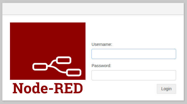

Is it possible to secure the node-red access on the IIot enterprise gateway, to prevent modification of the files without proper security access?
Hi @danempiric Yes, it is possible to add a security layer for the Node-RED node editor; first, you will need to SSH into the Enterprise IIoT Gateway:
Then you can access to the settings file by using the follow commands:
cd .node-red/
sudo nano settings.js
Here is a step-by-step guide for securing your Node-RED projects:
Or, you can follow the instructions in the ‘Editor & Admin API Security’ section here:
Additionally to save the changes and exit from nano editor, you can use the:
'Ctrl + X' shortcut
then type 'Y' to save.
Feel free to let us know if you have any questions.

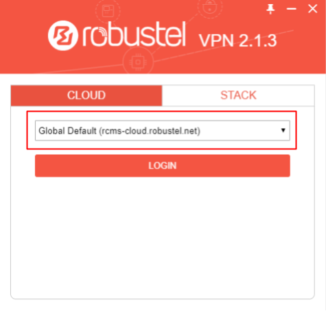

Additionally, is it possible to access the node red over the air?
I.e. If i have a gateway installed in the field on cellular data but want to update the node red config file, how would I go about doing that?
Hi @danempiric you can take a look at this option:
