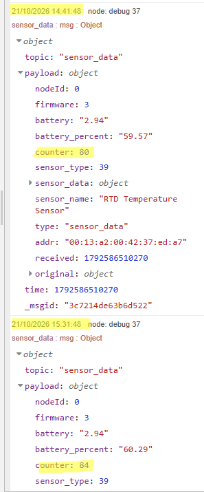

I have connected a debug message on a sensor and I have 2 consecutives messages but counter changed from 80 to 84.
Is it correct to interpret that 3 messages had been sent by the sensor (or tried to send) and not received by the gateway ?

Hi @ew3975 the sensor automatically enters configuration mode every hour. In this mode, the sensor transmits a packet, which also increments the counter value.

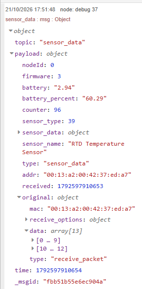

I updated NCD library in version 2.2.0 but there is nothing new in the debug window…
Hi @ew3975 can you press and release the reset button on your RTD sensor and share the messages you see into debug window.
Hi @Eduardo_Mtz
We just reset the sensor now and I have a new message.
Before the last message was at 10.01 AM.
The counter moved from 177 to 213
