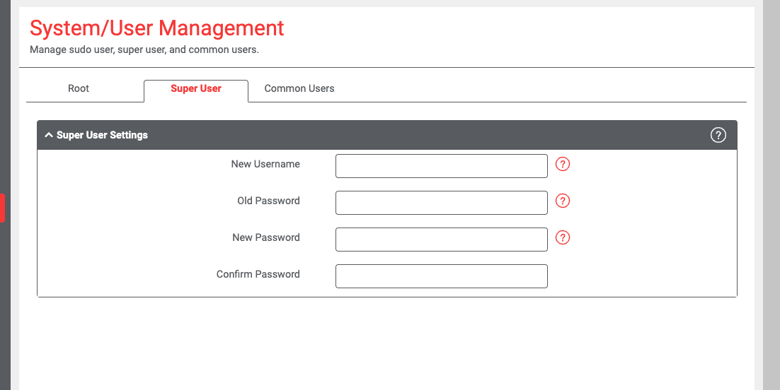

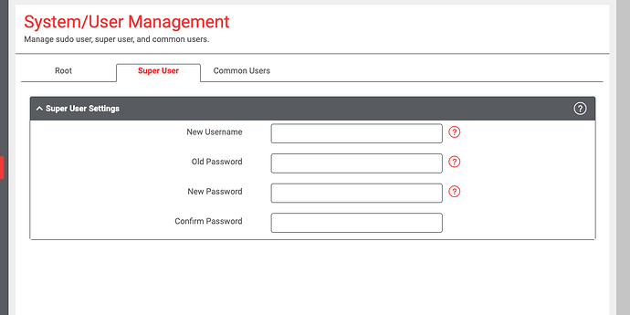

You can change the admin password from the web dashboard at System > User Management > Super User (tab). The default username and password can be found on the sticker on the Gateway next to the IP field in the format username/password with the / acting as a delimiter.
