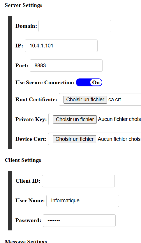

Hi! Sorry for the wait.
So I tried different methods to connect the gateway to mosquitto:
I was able to connect using port 1883 and 8883 using the credentials in the password files.
I even have made new certificates.
On my pc I can connect to the broker using the password, the ca.crt and TLS and Validate Certificate.
The problem I have right now is that the gateway is using the same ca.crt, the same password and have secure connection enabled but give me a unsupported protocol error.
OpenSSL Error[0]: error:0A000102:SSL routines::unsupported protocol or more often this
OpenSSL Error[0]: error:0A000412:SSL routines::ssl/tls alert bad certificate
If you still need a screen shot, I’ll send you one.
I don’t know what version is the latest for the micro gateway pr55-21 but it’s on v1.0.11
Thanks in advance!
Are you using both Root CA and private key files to verify connection? What MQTT versions do you have Mosquitto configured to accept(3.1, 3.1.1, 5.0, etc)? I have only tested the MQTT Gateways with version 3.1 and 3.1.1. I do not know that it will work with 5.0
Also are you entering a Client ID into the Gateway? Depending on Mosquitto configuration it may require a Client ID to be set.
I do have an article on connecting the Micro gateway to Mosquitto here:
I’m using the ca.crt in the mosquitto.conf, in mqtt explorer to connect locally (it works for me) and in the gateway (doesn’t work, get error). In the .conf file, the protocol is set to mqtt and after searching it is said that it use all of the version when using → protocol mqtt. I’m not entering a Client ID
The only problem is Secure Connection
I’m not sure what could be causing this issue. Can you try entering a Client ID in the MQTT Gateway to see if that resolves it? You can set it to something like NCD_Gateway
