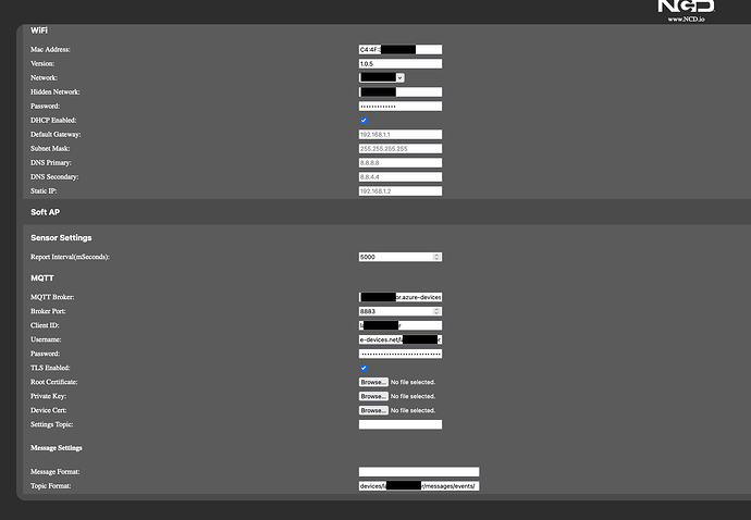

Is it possible to connect the PR5801_MQTT directly to an Azure IoT Hub? I am trying but failing, any feedback if this is possible and what the settings would be, would be appreciated.

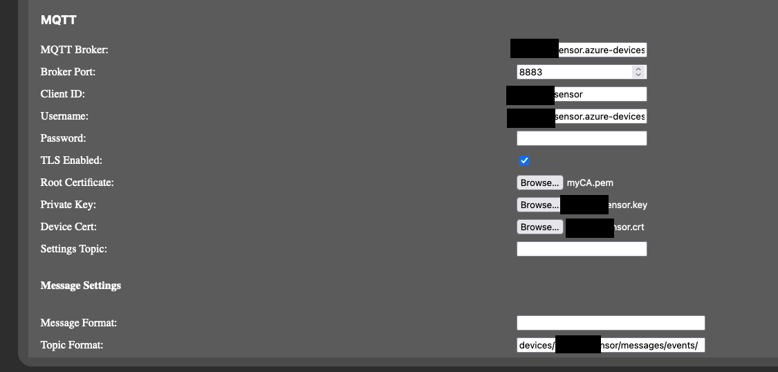

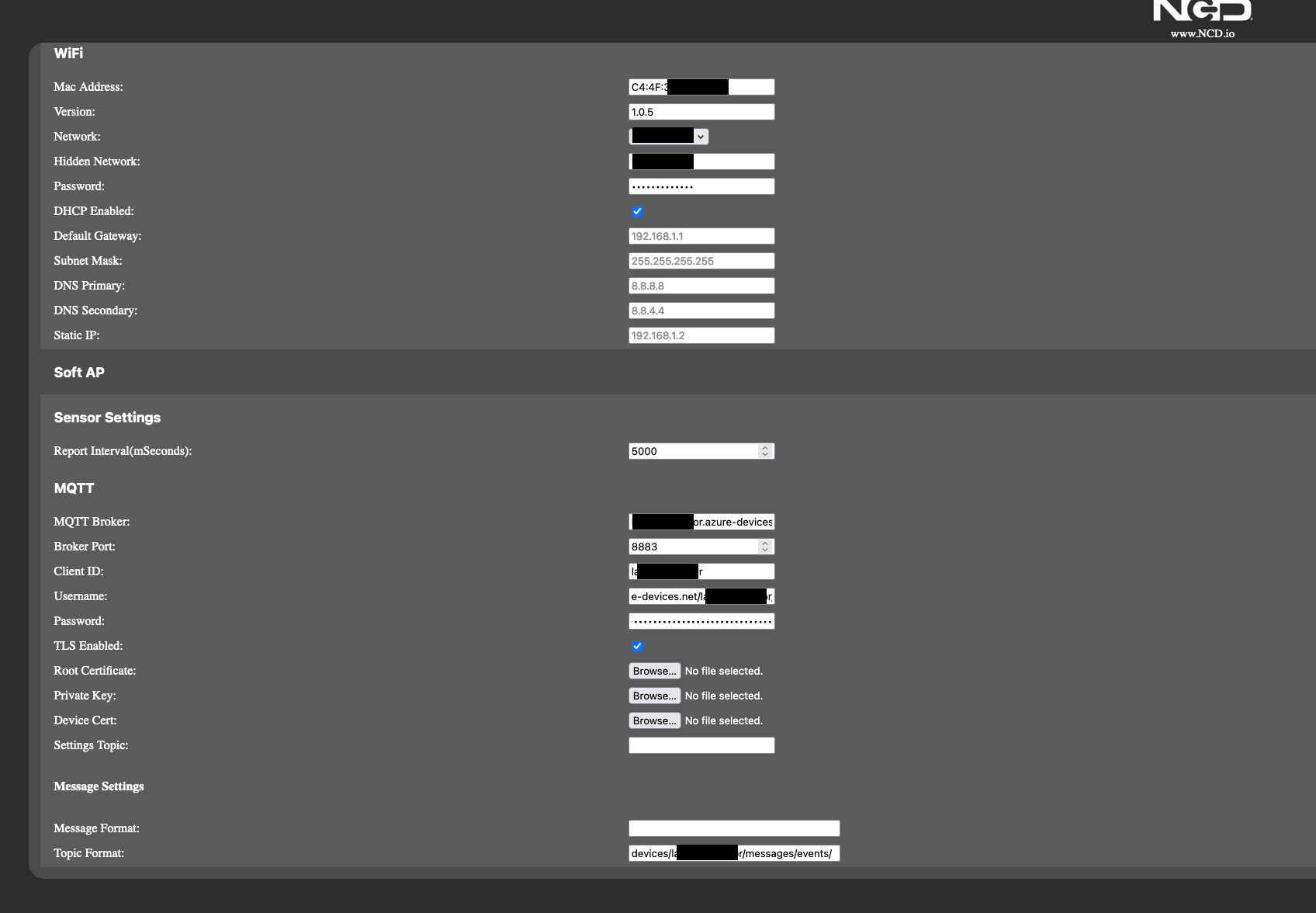

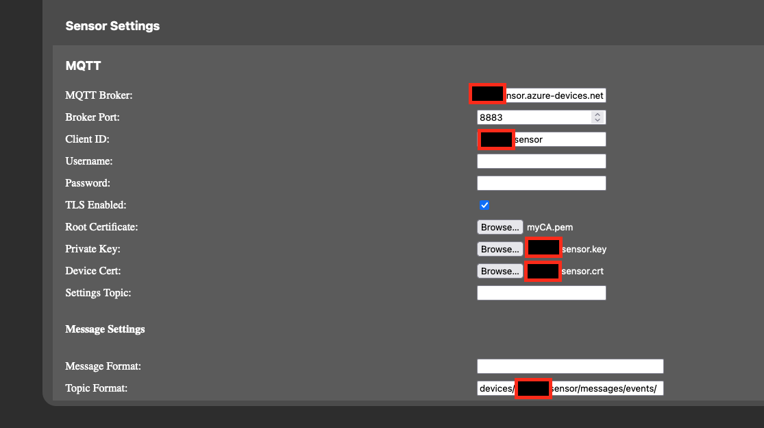

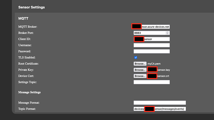

I created the device, generated a certs for a ca, then applied them and still get the red flasshing light. I also took the same device certs and used a python script to send a test message and that worked. I feel at this point i just dont have the right combo in the sensor’s settings.

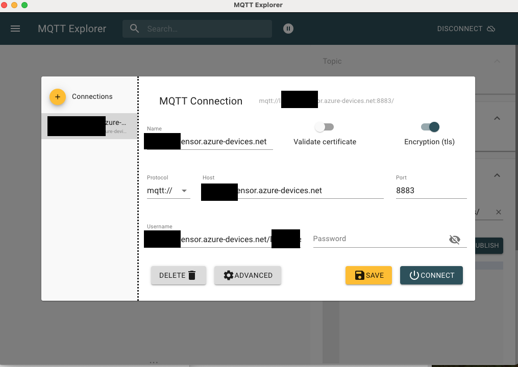

Are you able to publish successfully to that same topic from the python script without being disconnected? Can you test with MQTT Explorer here:
In MQTT explorer, got it to work and i could send on the topic. When i executed the python while that was connected it would disconnect the mqtt explorer. I noticed getting that to work that mqtt explorer required a username, so i put that in there: {iot-hub-name}.azure-devices.net/{device-id}/?api-version=2021-04-12
Added the username to the device and still get the flashing reds.
