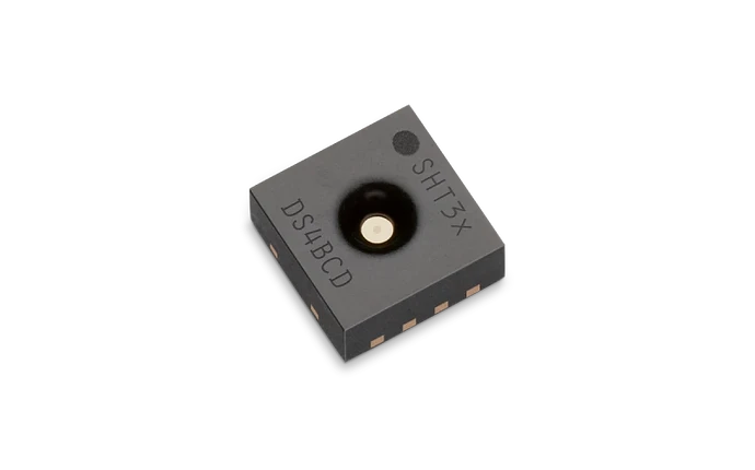

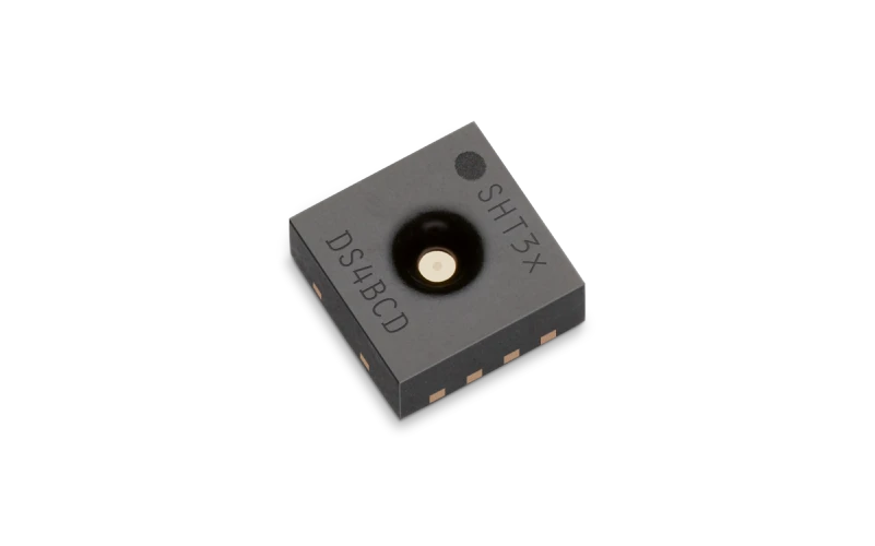

we use the temp humidity chipset from sensirion and these are digital sensor with ultra low drift and do not require any regular calibration. The sensor chipset comes pre calibrated ( lot calibration ) from the supplier.
