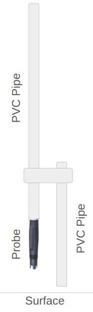

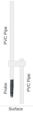

For installation, we recommend the following setup:
The white support pole shown is a standard PVC pipe. A second, shorter PVC pipe should be used to extend down and touch the bottom of the tank/sewer, ensuring that the probe assembly starts above the end of this pipe.
