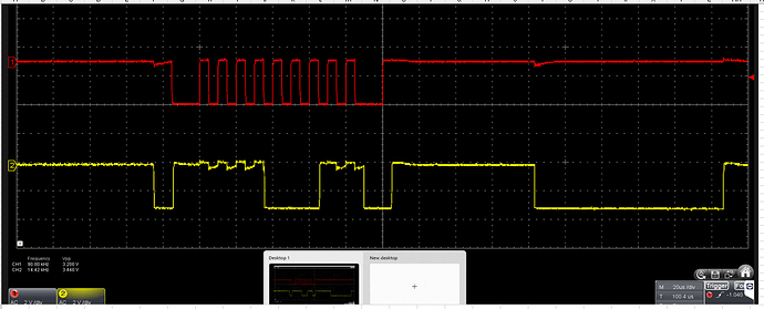

Here is a scope shot of the locked up condition. Controller can’t control SDA line.
None of the devices can communicate with the controller.

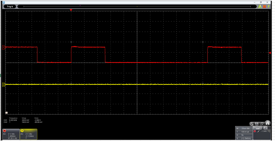

We cut the SDA line to the AMS5812 and the micro controller could control the SDA line.
And the controller could get data from the other devices
See scope shot.

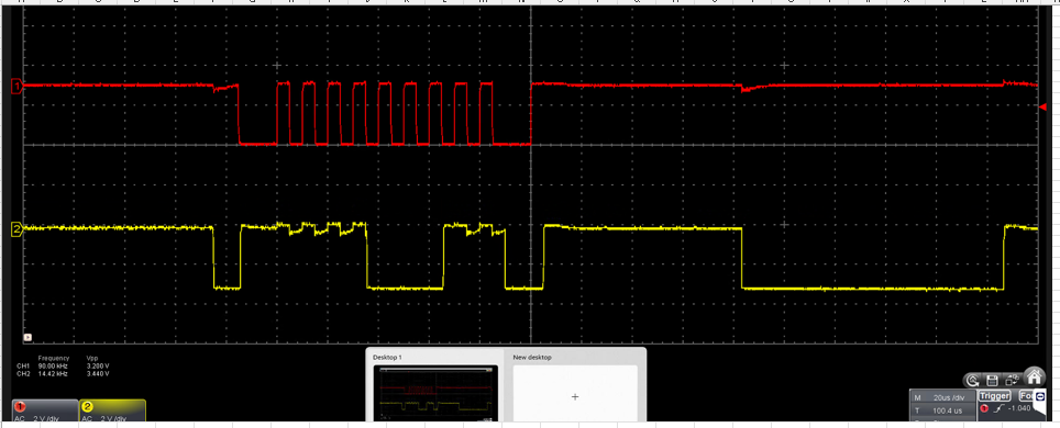

When we reconnect the SDA line it goes back to the first scope image.

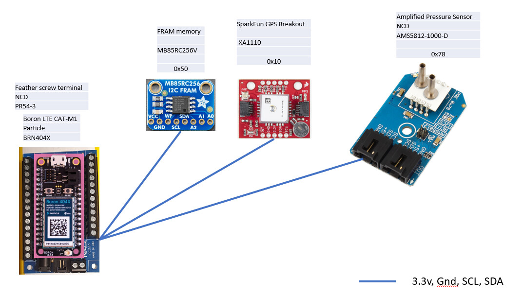

Here is a simple connection diagram.
