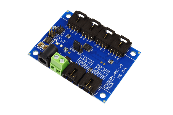

So I don’t think it can be a simple task to reprogram it. I think the most direct solution would be a multiplexer as @TravisE_NCD_Technica mentioned here:

The only option to use your two sensors would be to use an I2C bus multiplexer:
