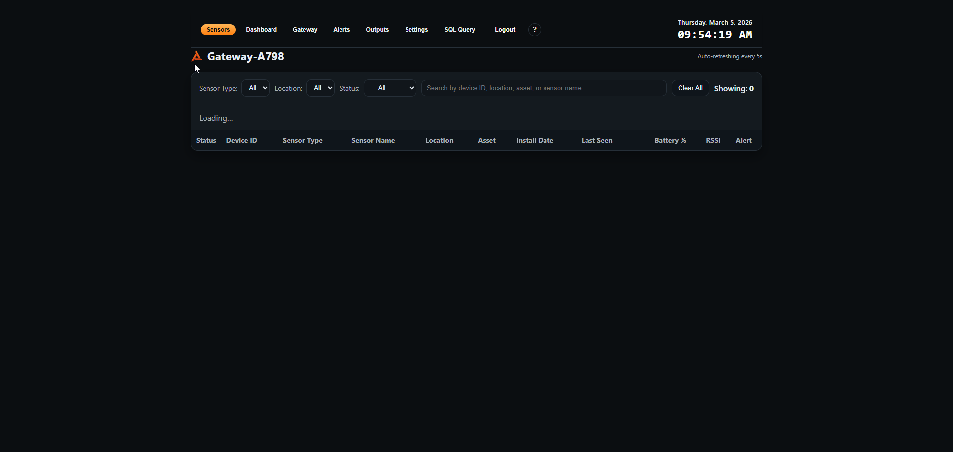

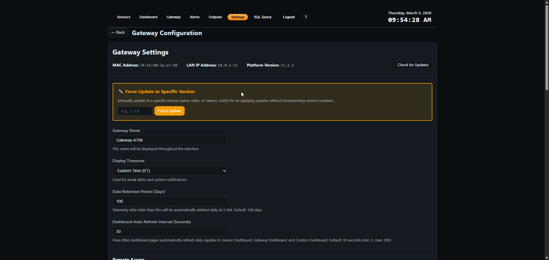

After upgrading the Atrium Gateway to Platform Version: v1.1.2, our sensor wont come back

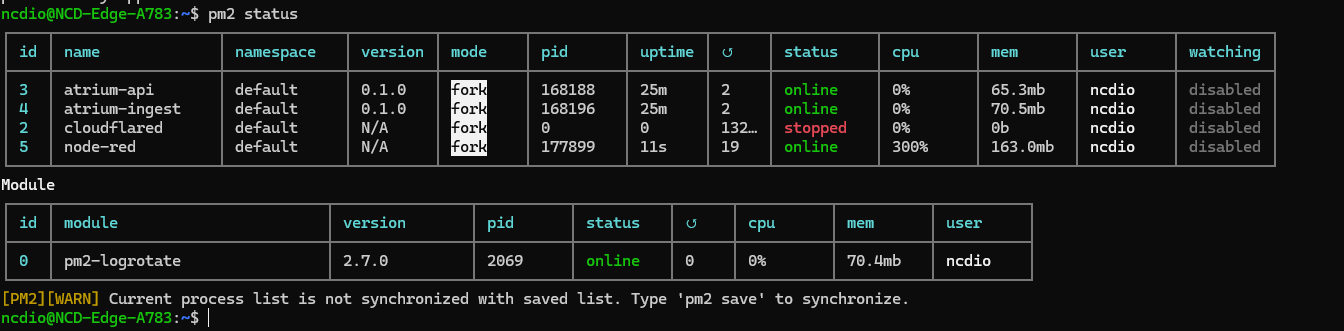

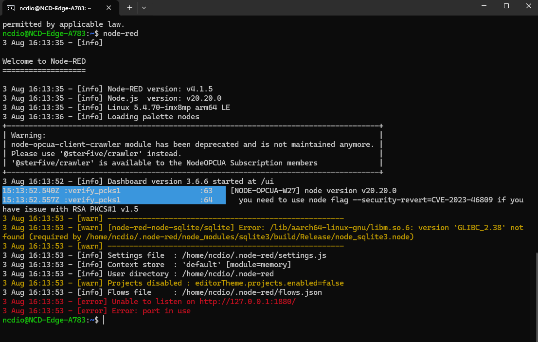

I am not having any luck re-flashing Atrium. I noticed that after the reset Node Red no longer works anymore. I tried to manually start it and this is what I’ve got. Any help would is greatly appreciated. Thanks!
In the terminal enter:
pm2 status
Please send screen shots of what you see from that.
Node-Red should be automatically started by PM2. You do not want to start in manually because it would conflict.
Yeah, definitely looks like there’s an issue Cloudflared has restarted 7,958 times and node-red has restarted 207 times.

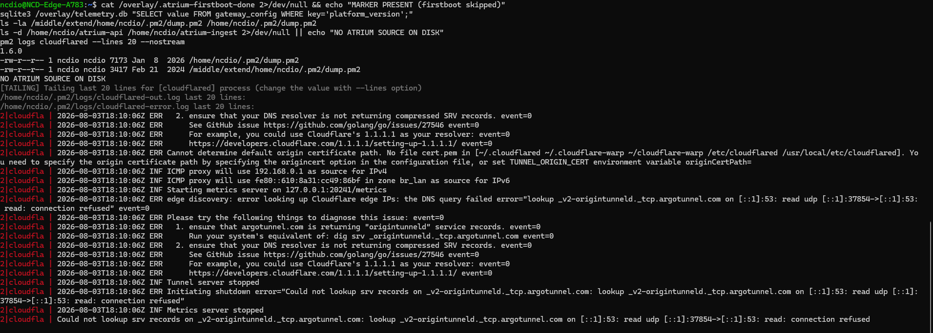

Before that though so I can collect as much information on what lead to this issue failure could you run this command in the SSH terminal and provide the response:
cat /overlay/.atrium-firstboot-done 2>/dev/null && echo "MARKER PRESENT (firstboot skipped)"
sqlite3 /overlay/telemetry.db "SELECT value FROM gateway_config WHERE key='platform_version';"
ls -la /middle/extend/home/ncdio/.pm2/dump.pm2 /home/ncdio/.pm2/dump.pm2
ls -d /home/ncdio/atrium-api /home/ncdio/atrium-ingest 2>/dev/null || echo "NO ATRIUM SOURCE ON DISK"
pm2 logs cloudflared --lines 20 --nostream

So, after running the OTA Update, Node Red is accessible on 1880 and contains the flows for Atrium as well as the other stuff I was working on. The flows are stopped due to the SQLite error in the picture. This is similar to what happened after the SQLite nodes were updated in the palette. What would you advise as the next move? Also, Atrium does not appear to be available yet either. Thanks!

Here’s the most recent pm2 status.

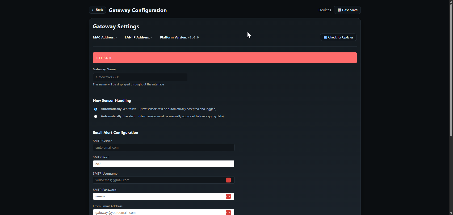

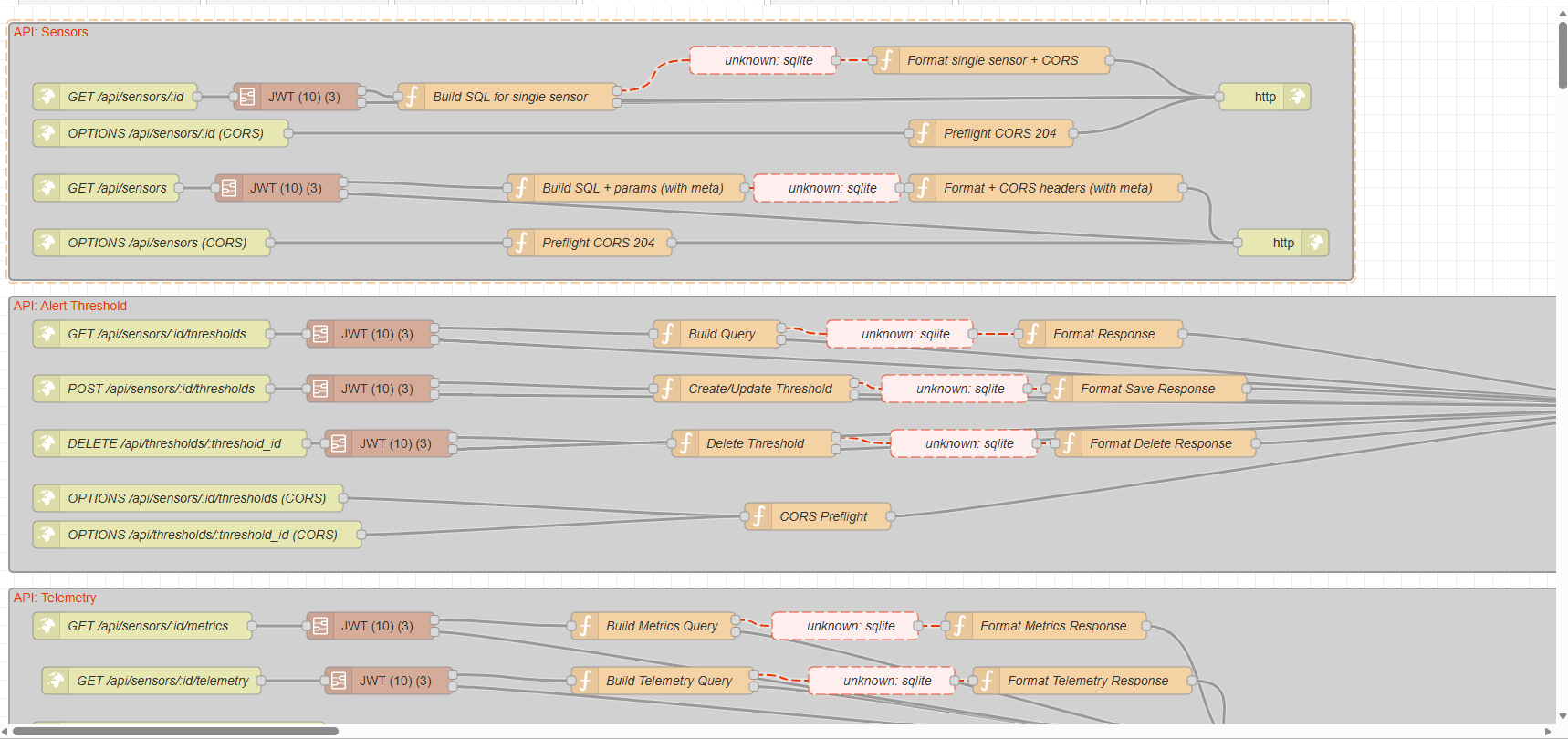

No the local ip does not work. I do use node red for more than just collecting ncd data. The flows are not able to run due to the missing SQLite nodes, see screenshot. I feel like with the current state of the flows Atrium is unable to restart. Let me know what you think. Thanks!
It appears the update stalled and did not complete.
I’m really not concerned with Node-Red or the flows not working at this point. Those flows would be removed upon a successful update. The issue is that the update is not completing.
