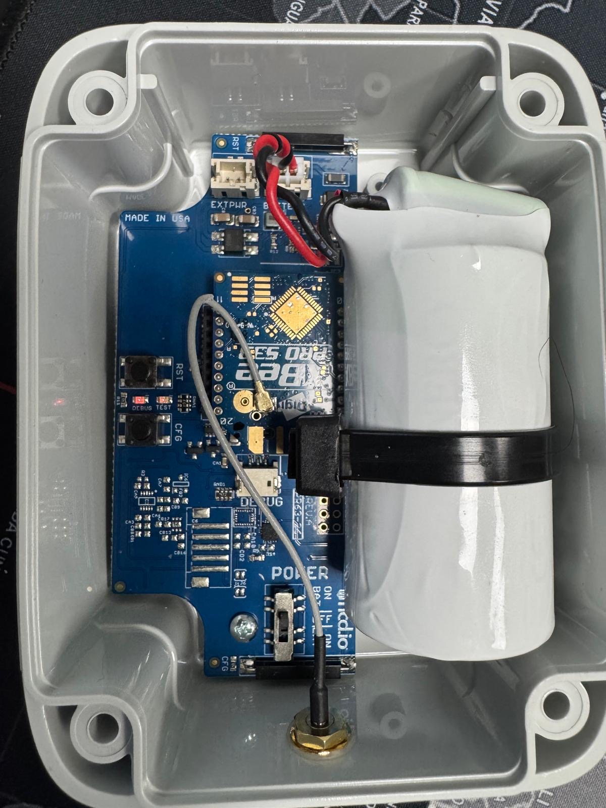

After a clean power-up on batteries with no buttons pressed, both the TEST LED and the DEBUG LED remain continuously lit. They do not blink and then turn off. My understanding is that in normal RUN mode the sensor should sleep with the LEDs off, flashing only on transmission. This constant illumination seems to indicate the sensor is not entering normal operating mode.

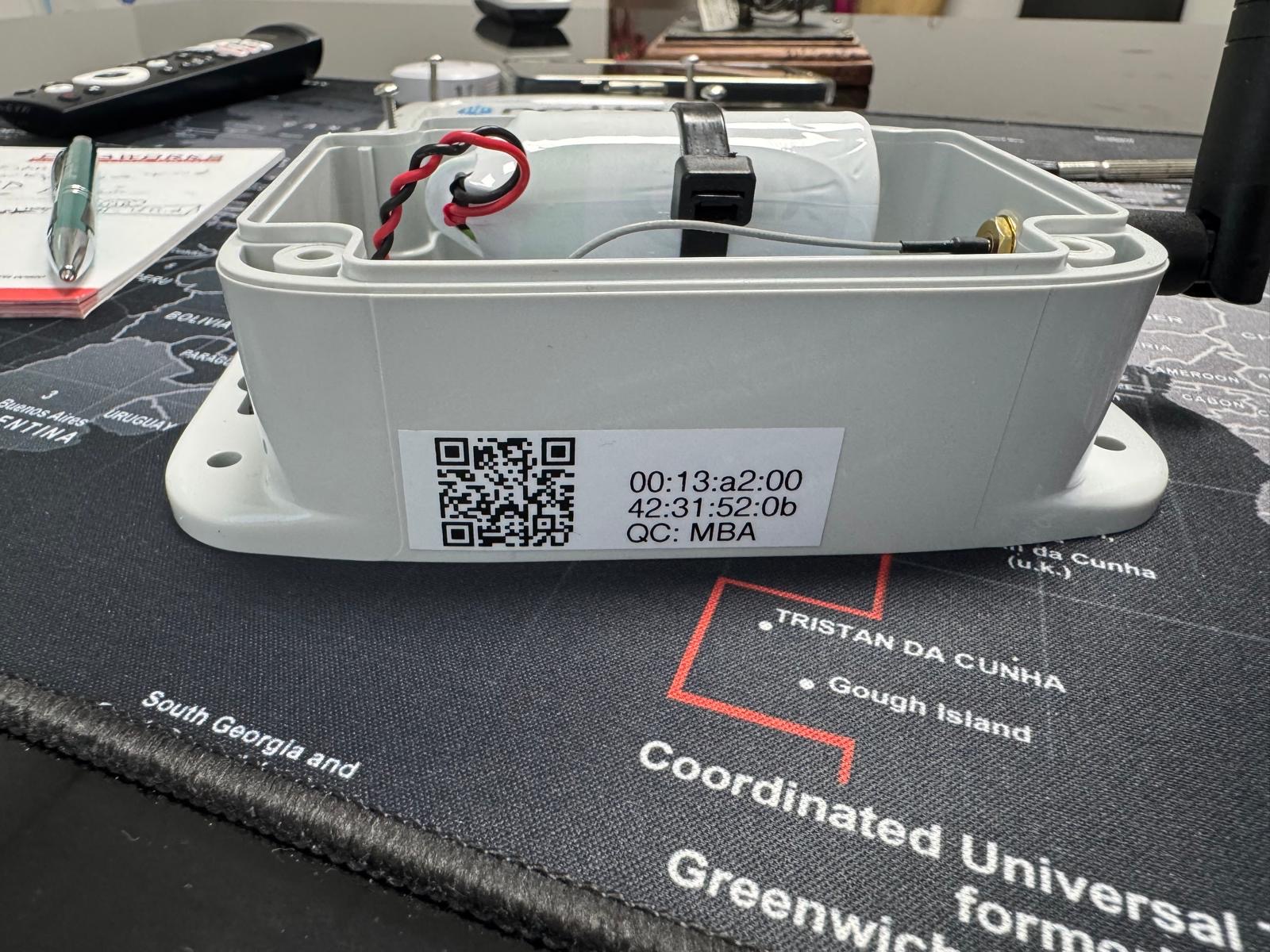

Can you share a picture of the hardware?
Are they dim or full on?
If you have magnets installed on the device, remove them.
Hi @frankvasconcelos thank you for the pictures, are you available for a zoom call in order we can take a look at it?

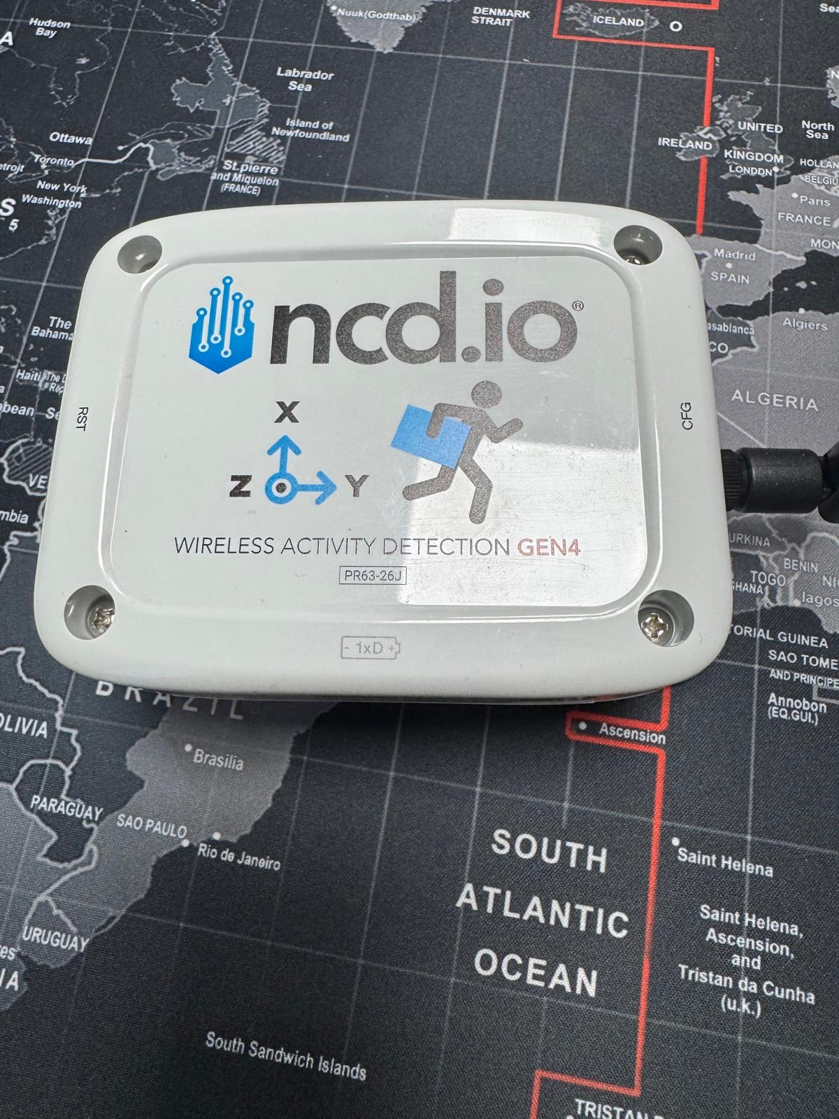

On the other hand, the sensor I received looks different from the one I ordered. At least the image on the purchase page is different from the sensor I received. This is an image of the sensor I received:
This is the image published on the page:
Hi @frankvasconcelos Yes, your device is the new Wireless Activity Detection Sensor Gen4 (rectangular box). It includes several new hardware and firmware features compared to the previous version (square box). We are currently working on updating the documentation for this device, but in the meantime, please let us know if you have any questions about it
