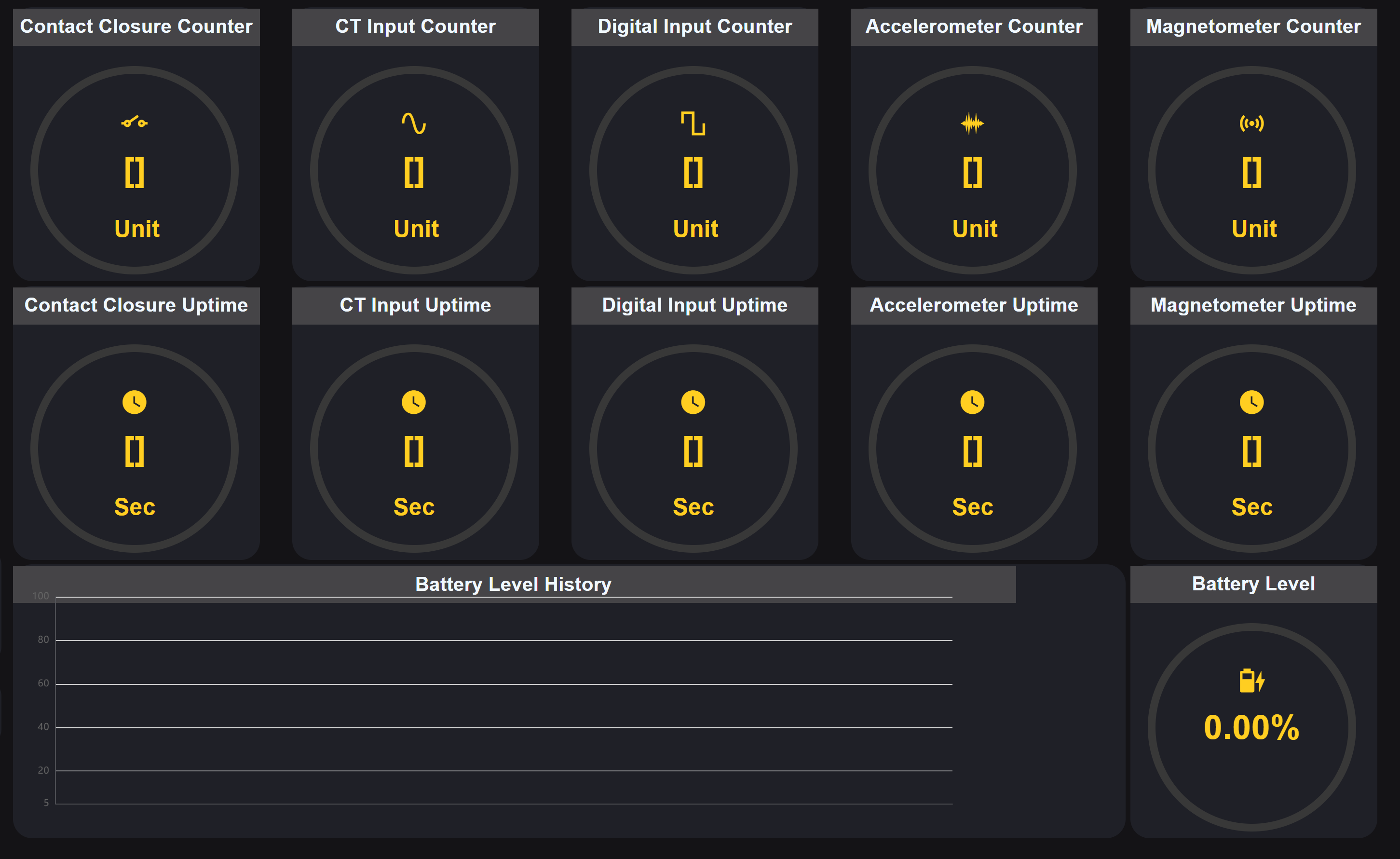

I am using the machine uptime monitoring sensor that I got a few months ago with the magnetometer/accelerometer and I want to be able to see the time domain data bring transmitted. I found the machine uptime library/dashboard but it doesn’t have continuous data just a counter and I haven’t been able to figure out how to use the accelerometer for real-time collection as continuously as possible.

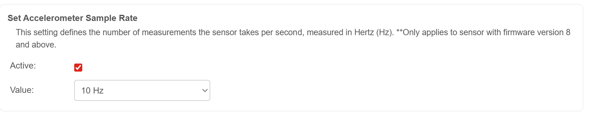

Is sending the “time domain data transmission” possible through node red? I have to think it is because the dashboard has a battery level history in the time domain and I can set the sampling rate for the accelerometer.

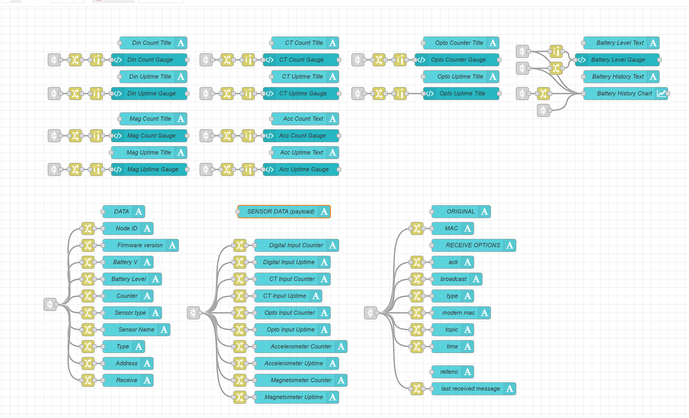

Since this device supports different kinds of input, the dashboard template will display the actual counters and uptime (in seconds) values, along with a battery percentage history. It is designed as a simple template to view the sensor data in an easy-to-read format. In order to get started I would recommend to test the behavior using the Node-RED editor into the Debug window.
