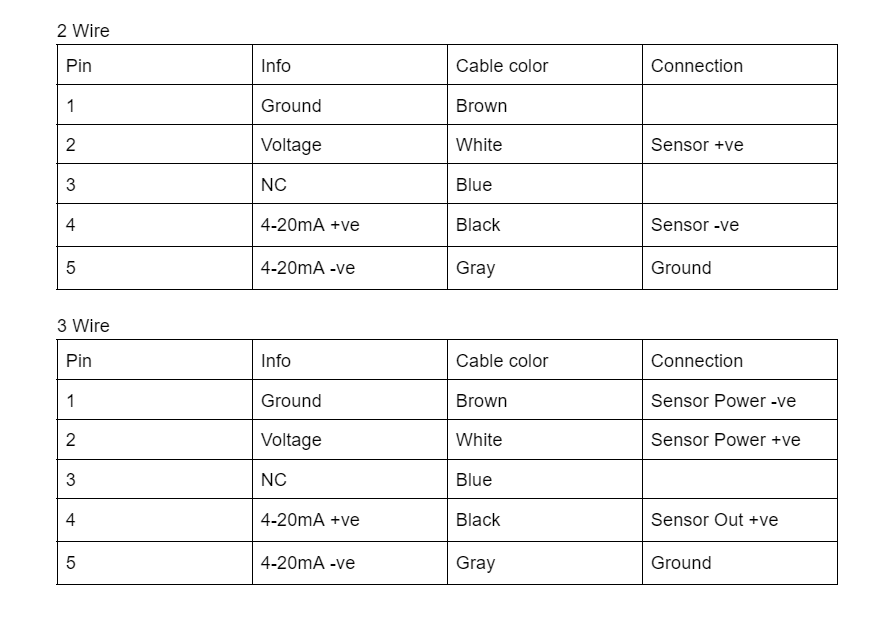

1 - The M12 pigtail from NCD has a blue and brown wire coming out of it. My transducer sensor from china has a red and black wire. Which connection goes where?

  1. wiring can be found in manual
    https://ncd.io/industrial-iot-wireless-high-resolution-4-20ma-receiver-product-manual/?_ga=2.211385301.175351377.1666092354-2107108825.1658182495

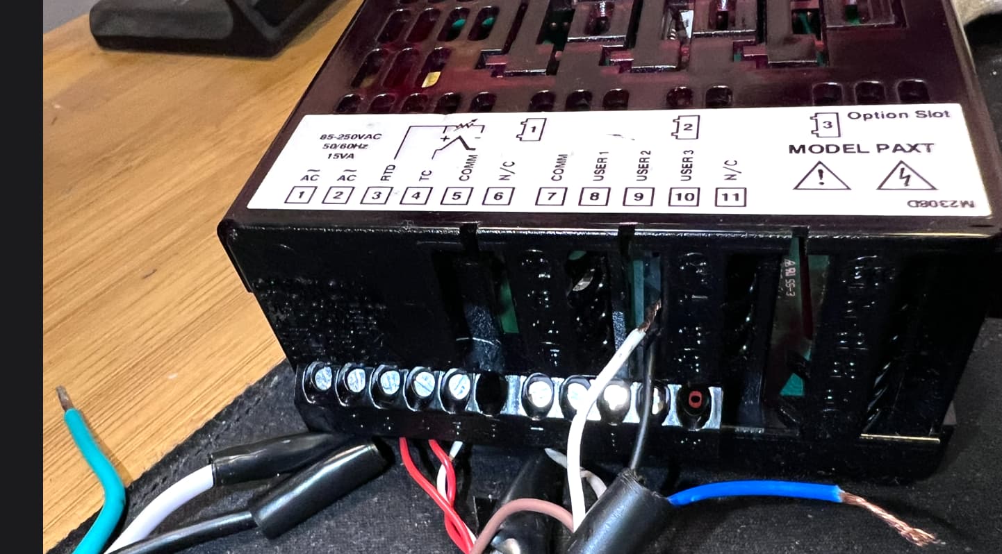

I have the same issue with the M12 Connection (PR55-5) — cable, but I am planning on using a loop powered device.

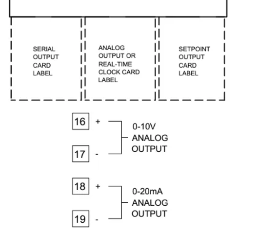

I tried plugging in the blue + (18) and the brown - (19) but not getting any information in nodered. Am I missing some piece of the wiring?
Picture of the device wiring here:

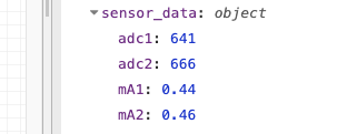

reading of the information:

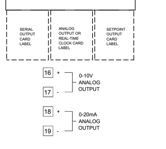

wiring is like this
Thanks, that wiring schematic seems different than what is in the manual? Or am I reading this incorrectly.

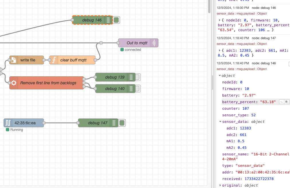

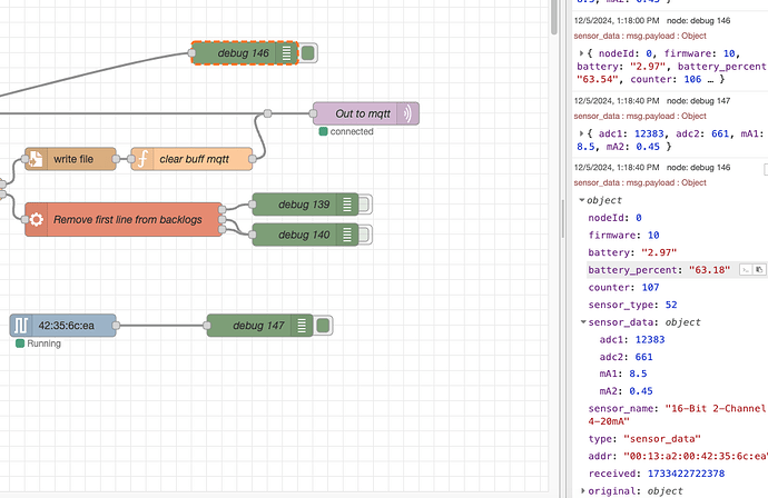

Otherwise, the mA or ADC reading doesn’t make sense for the scaling of output -100 to 500F (4-20ma).
adc1: 981
adc2: 666
mA1: 0.67
mA2: 0.46
I’m using this information - How to Convert 4-20mA Current Loop to Voltage/Digital Conversion - NCD.io
Blue — 4-20mA +Ve
White — External Power Supply +ve
Brown — 4-20mA -Ve
Black — Ground
Gray — 16V Supply ( To power External Sensor)
M12 Connection (PR55-48)
Blue — 4-20mA +Ve
Brown — External Power Supply -ve
Black — Ground
Gray — 16V Supply ( Test Point)
based on your reading looks like device is not connected to any 4-20mA signal.
The wiring you are referring is for gen 1 devices and the one you have is gen 2.
this is how i’m wired to the device with 18+ (top) white, and 19- (bottom) black and still not getting any reading.
I have the grey wired into the common terminal.

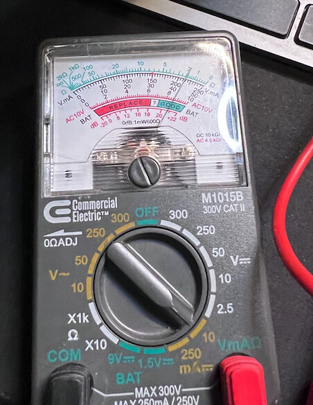

before we go into checking the device can you measure the mA output and see if its truly outputting a signal ?
I am getting some power without the device wires plugged in.’

the housing is 2 channel 4-20ma current loop receiver, PR55-47_CR2
I plugged in using the black on +(18) and white on -(19), and getting a 1.4mA reading now, but still not the full signal.

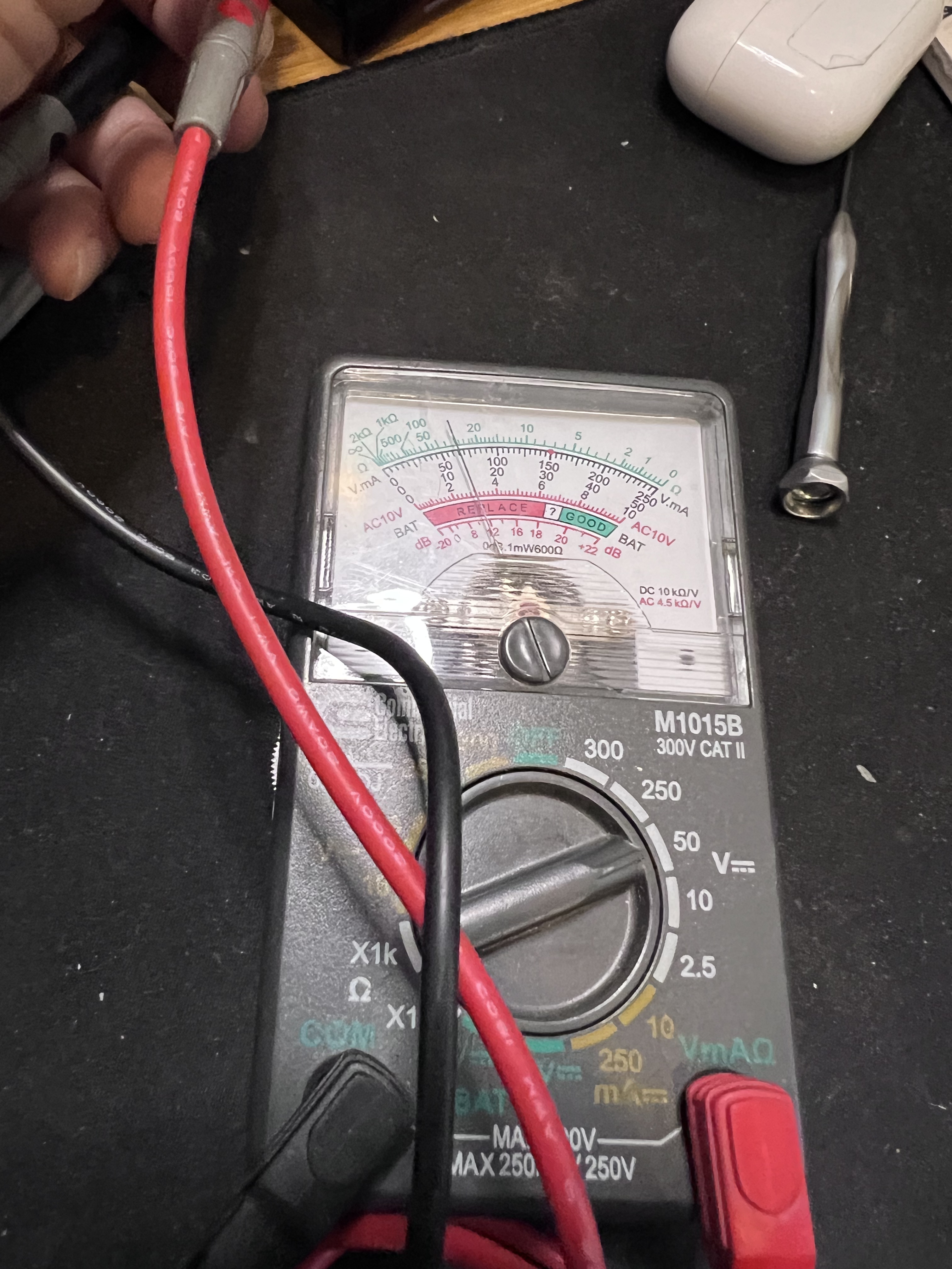

You should be able to measure voltage across the 4-20mA wires and see if there is any loop voltage
I’m getting about 12V across the terminals.

I have reconnected using black to terminal 18 (+) and grey to terminal 19(-), brown to ground and now getting a reasonable temp reading of 8.5mA for my temp sensor reading 68.5F, scaling -100 to 500F.
Is there a way to get more decimals from the mA reading?
