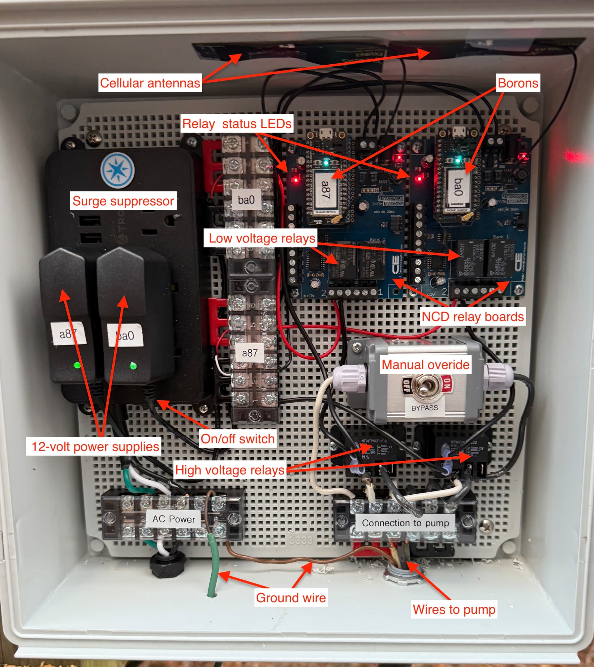

My application - which you and i have discussed off and on over the years - involves turning a water pump in a well on or off as a function the water level in a large storage tank. Everything has been working great for a long time now except that once in a while the pump gets disconnected from power (Pumptec turns it off, its circuit breaker trips or lightning destroys the pump controller).
My application doesn’t currently know if the pump is running or not, only that is has “asked” it to turn on via contact closure. It usually takes about 1-1/2 hours to refill the tank when the float switch in the tank calls for more water but if it is still ‘asking’ for water after 2-1/2 hours, my app sends out an alert via email and/or text. At that point, we don’t know if there is a massive leak in the water distribution system, someone has left a shower or something else on for a long period or the pump isn’t actually running. The ability to monitor the current on the wires feeding the pump would allow us to determine if the problem is related to the pump itself and, if so, point us in the right direction for further problem identification and resolution.

Ok. I remember this. What board do you currently have installed at the pump house? Isn’t it something like a relay board with an IoT interface and a Particle or ESP32 module installed? Does it have available GPIO lines? If so you could use a digital CT with a variable trip. Something like this:

Yes, NCD relay board with attached Particle Boron. Two of them, actually, in parallel. None of the GPIO lines are currenty in use, just one relay per board. The gizmo that you suggest should, indeed, work; perfect, in fact!

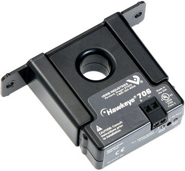

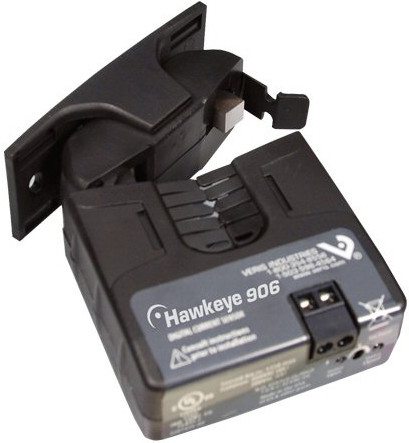

We carried those Veris sensors at one time but didn’t sell that many of them. They’re out of stock on our site but I actually still have a few laying around in inventory. I have these:
Would any of those work?
