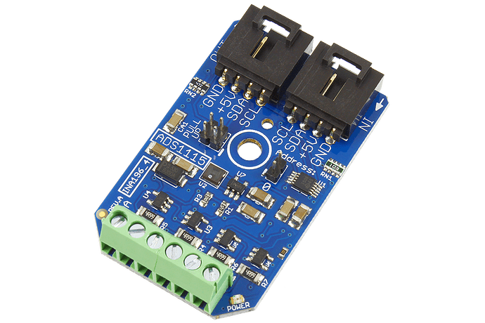

I’m trying to understand what type of interface I need. I’m looking at the 4-Channel 4-20 mA Current Loop Receiver 16-Bit ADS1115 I2C Mini Module.
I’m wondering if the interface or the device provides the voltage source? Is the module configurable to be the source or not?

The ncd product you listed here does provide loop power.
I will recommend this one
How do I know if an interface provides the voltage source? I don’t see any documentation about that.
are you talking about the ncd board or the pressure sensor?
How do I know if the ndc.io board provides or expects the voltage source. I’ll measure the voltage on the device (flow sensor) to see if it is providing a voltage source.
checkout the product bullet points
  • Onboard 16V Voltage Current Loop Supply
This mentions the voltage supply - but you suggested that this product did not have the voltage source. Also I think the customary voltage for this type of circuit is 24V, but this mentions 16V. Confused.
