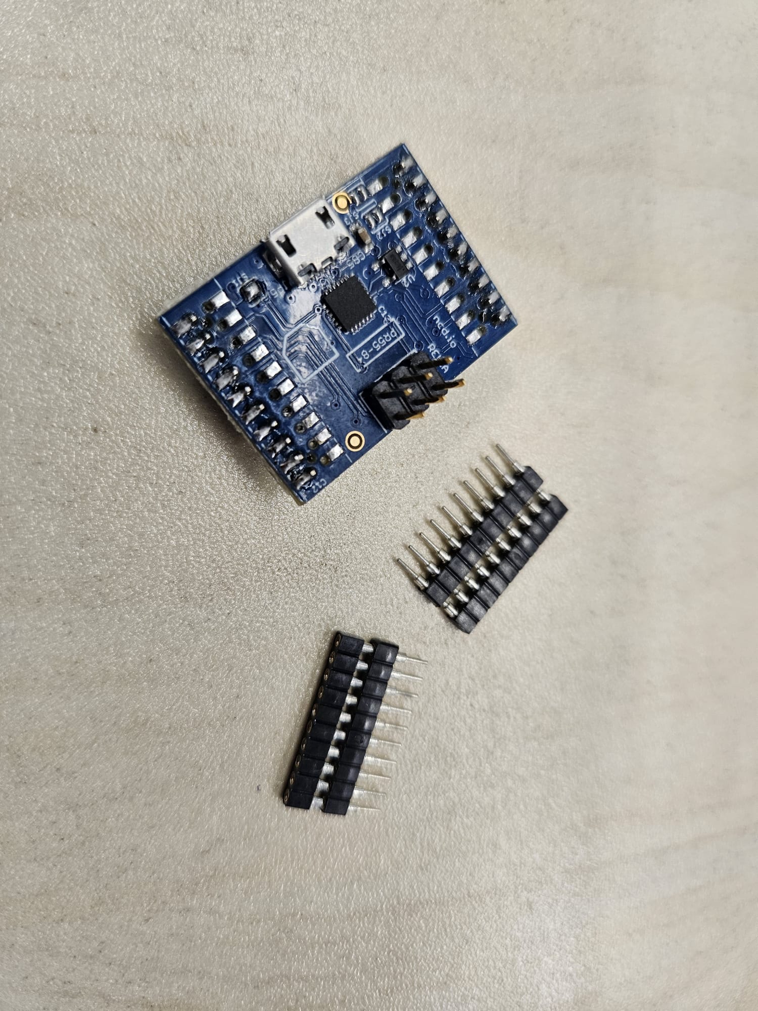

Here are the firmware update instructions
The firmware update hardware you have will plug over the radio module
Let me know if you run into any issues

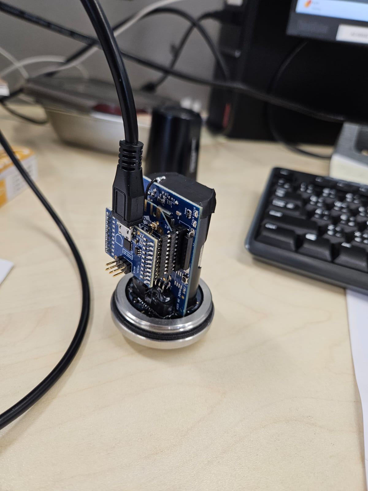

@Bhaskar

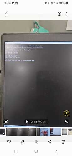

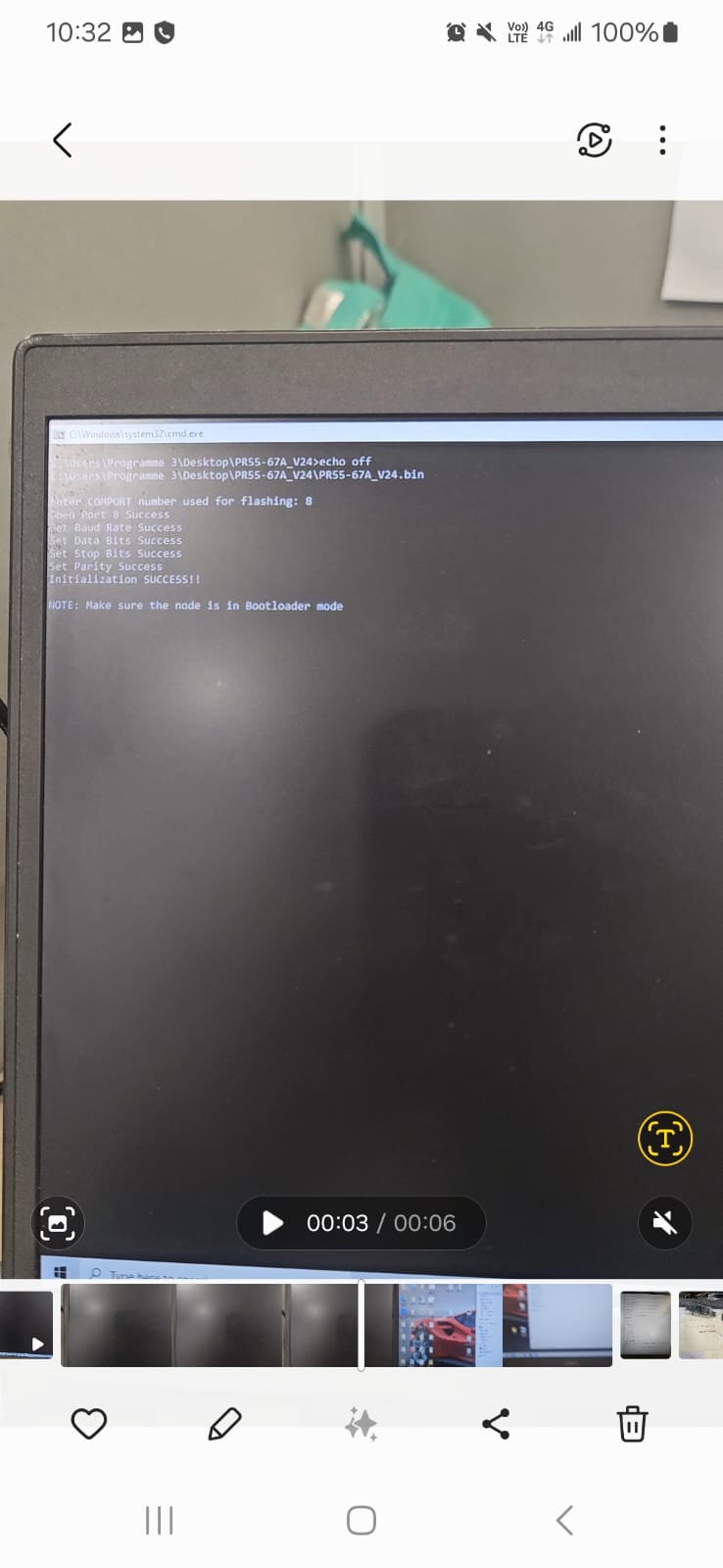

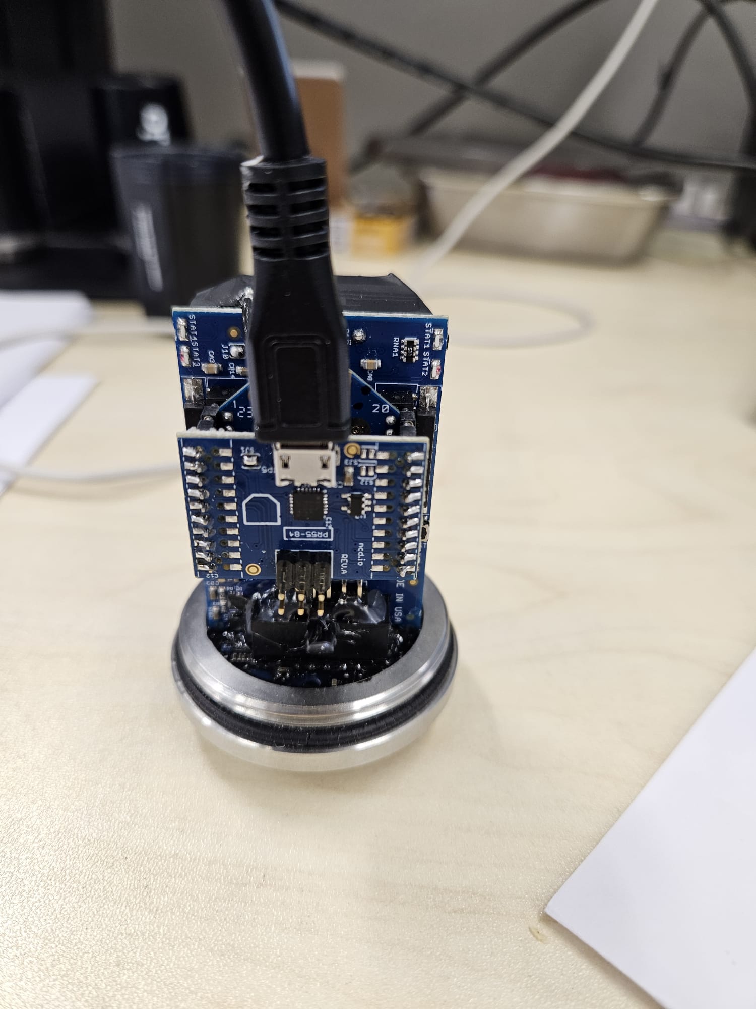

Thank you for the information. I followed your YouTube video (firmware upgrade), but it’s not working for me.
Connection
Screen capture
Could you please let me know where I might be going wrong? Thanks
Best regards,
Howard
Did you put the board in bootloader mode?
Press and hold cfg button
Press and release reset while holding cfg
Release cfg button

I followed Bhaskar’s instructions for entering bootloader mode and noticed that two red lights remain illuminated. See the picture below, I assume this indicates that the sensor is in bootloader mode.
After that, I pressed ‘FW Upgrade
However, nothing happened. Could you please assist me?

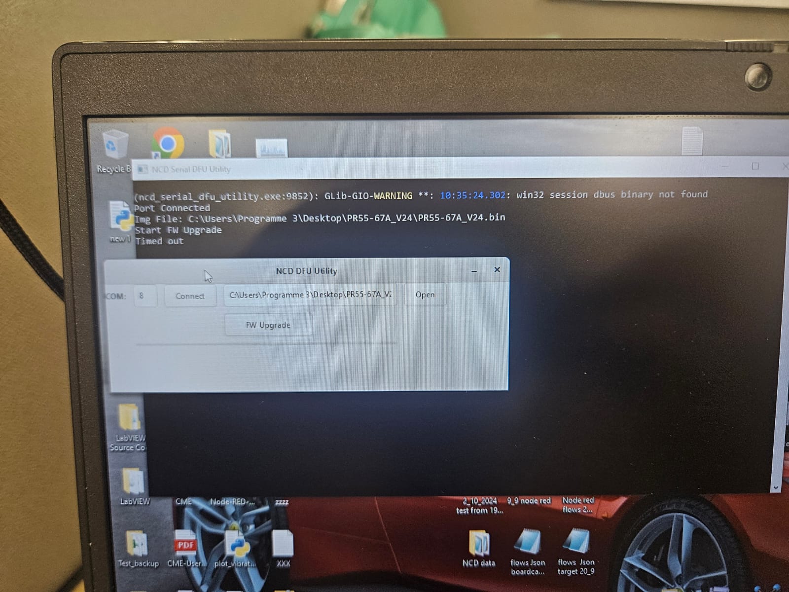

can you put the firmware update folder on desktop and try

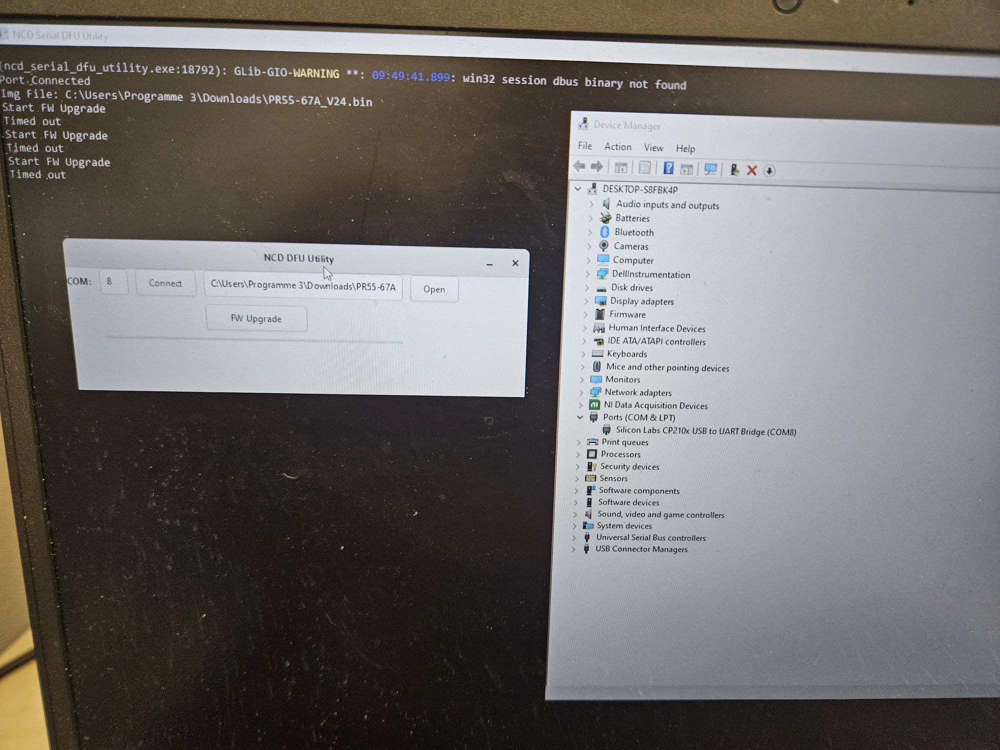

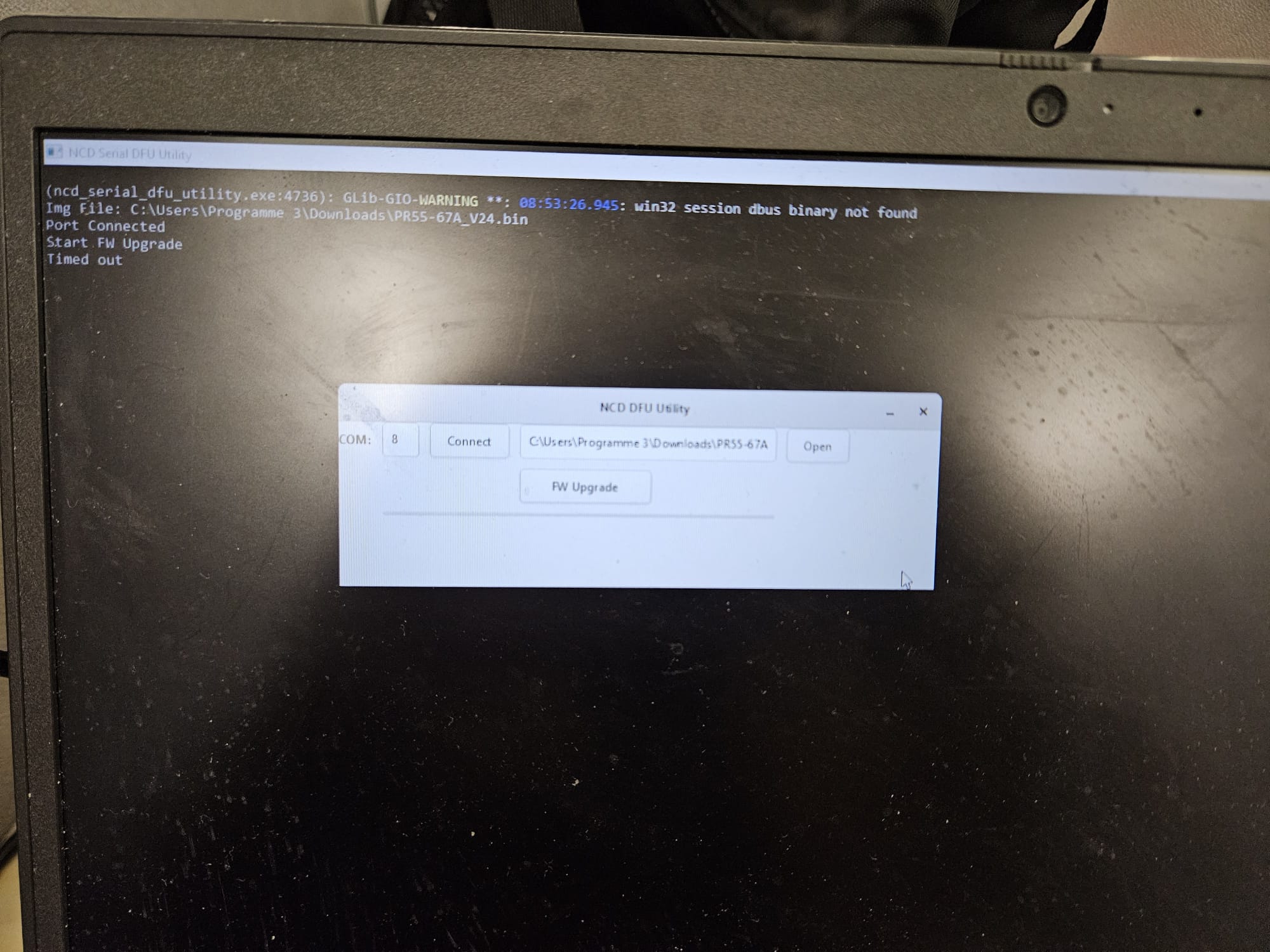

HI Bhaskar,
Following your suggestion, there has been no change. Please see the images below:
I also tried the method outlined in this link:
However, the CMD window closes very quickly after I input the port number and there is nothing change for the firmware. Feel exhausted.
Best regards,
Howard
your file path has space in it. can you remove the space between path and 3
Hi Bhaskar,
It works. Thanks.
