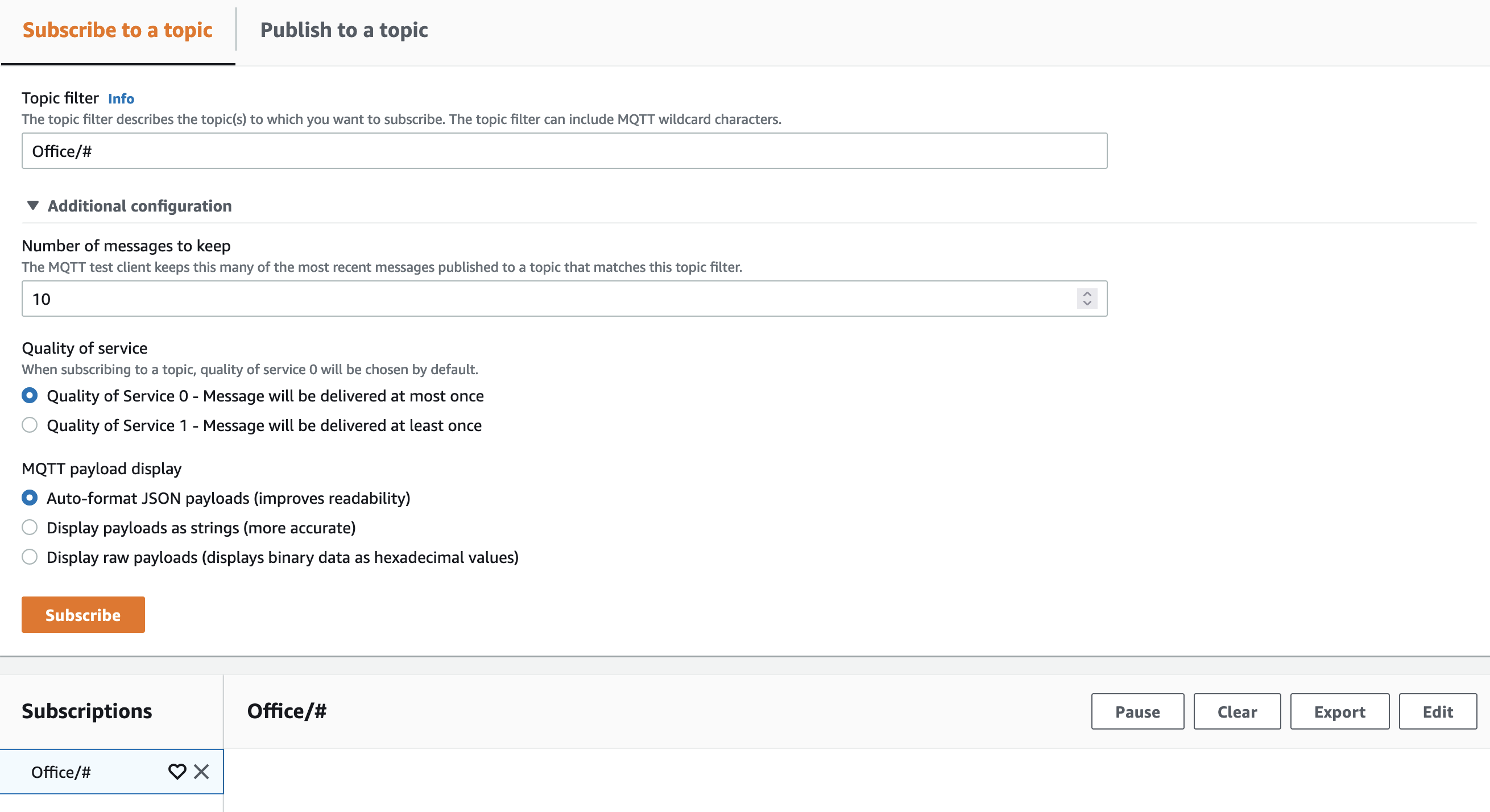

I am able to configure the AWS Temp/Humidity sensor and it seems as if I am receiving messages but when I subscribe to the topic that I’ve defined it doesn’t seem to be sending any messages.
Any help you could offer in this would be greatly appreciated.

Thank you for your response. These images are what I have configured on the sensor and what I have on AWS.
Is there any other information that I can provide to get some more troubleshooting? I see metrics from the IOT interface showing that it is connecting.
Hi James,
Can you send a screen shot of your entire browser window where you are attempting to subscribe to the topic for the device? It looks like you only snipped part of the window, I need to see the entire screen.

Here is the entire screen
The first screen shot shows the configuration and the lower portion shows that there are no messages coming in.

Thank you for all your help. I really appreciate your attention to this. I have changed the configuration of the device over to us-east-2 (Ohio) and I still don’t see anything coming over when I subscribe to the topic (Office/#). In the metrics I do see the below
… but I still see the following when I subscribe to the topic.
I am wondering if my configuration for the topic on the device is incorrect. Does it look right to you?

I don’t know what happened but it looks like it is reporting data according to my subscription of the topic. I think this is sufficient for my testing today. I will have to place it in the grow room and get some good data and stay in touch. Thank you for all of your help today.
