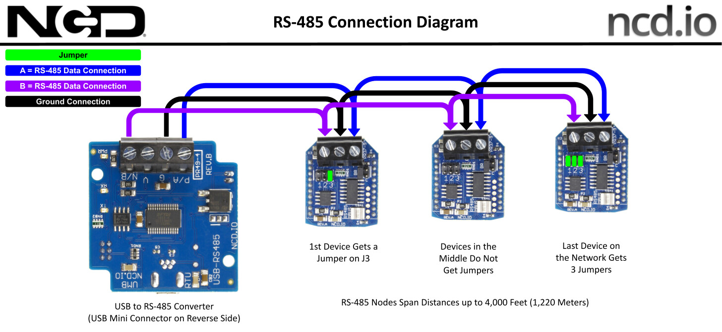

See Section Changing Baud rates of the guide here:
115200 baud is not recommended as there may be communication problems.
