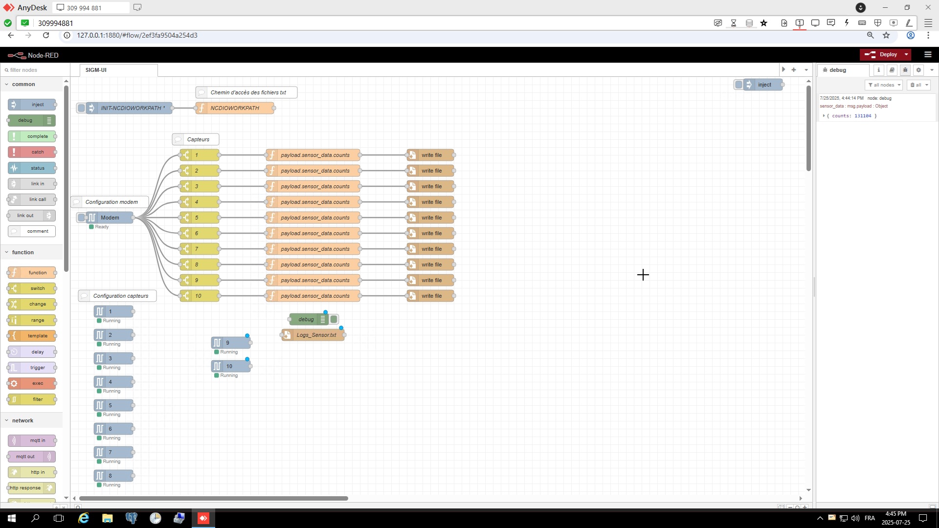

Here’s my flow:

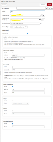

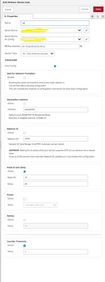

And here’s his configuration:
Can anyone help me ?

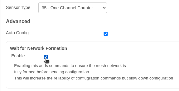

Hi @frederic Sure, could you please enable the Wait for Network Formation checkbox?
Then, connect a debug node to the output of your Wireless Devices nodes so we can take a look at the Config Results message. After that, please try the configuration again.

HI Eduardo, is this what you are waiting for:
9/10/2025, 11:30:26 AMnode: debug
Config Results : msg.payload : Object
object
id_and_delay: true
config_set_counter_threshold_35: true
You wrote that The range for this value is from 0 to 65534 and must be multiple of 100, but we do have the same counter transmitter which the threshold is set to 1 and it works…

Hi @frederic yes we are waiting for config_set_counter_threshold_35: true this means it was configured correctly. Did you get this message after configuration?
Yes I did and threshold value is set to 1…
