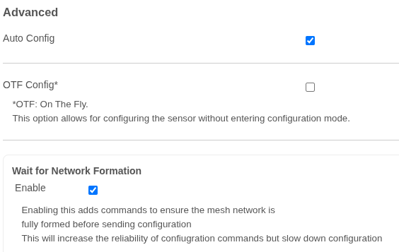

  1. Are you using a manual or automatic configuration? These sensors support OTF (On-the-Fly) configuration. I ask because the OTF Config checkbox is currently disabled on your Wireless Device nodes. This prevents the sensors from taking a new configuration when they send a FLY message.
To try to resolve this, we recommend the following steps:
  • Disable the Network ID checkbox on all your Wireless Device nodes.
  • If you are using Automatic OTF, enable the OTF Config checkbox.
  • Click the Deploy button to save and apply the changes.
  • Reset the sensor or wait for the next FLY message to apply the configuration. If you choose to reset the sensors to force a FLY message, we recommend resetting one sensor at a time. Wait until the configuration is complete (you’ll receive a Config Results message) before resetting the next sensor. This allows each sensor enough time to configure itself properly.
