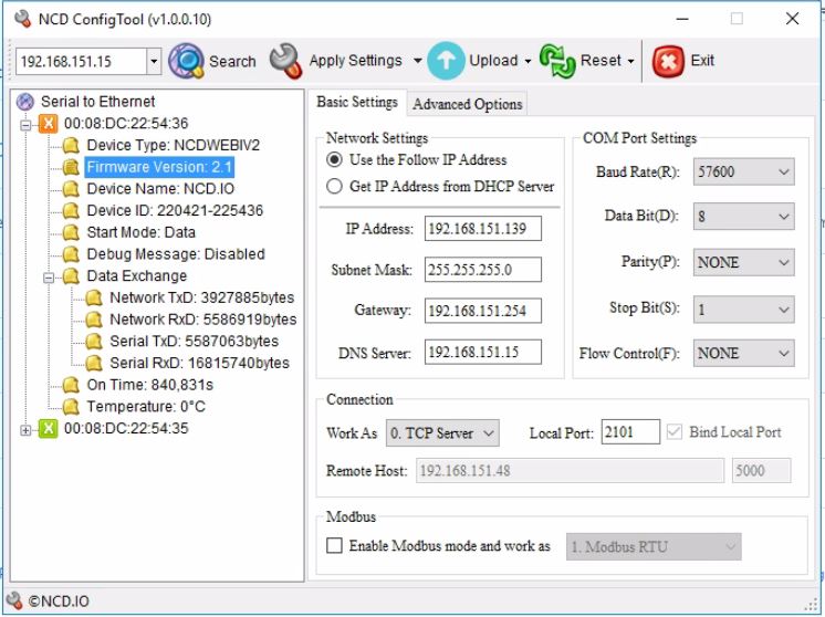

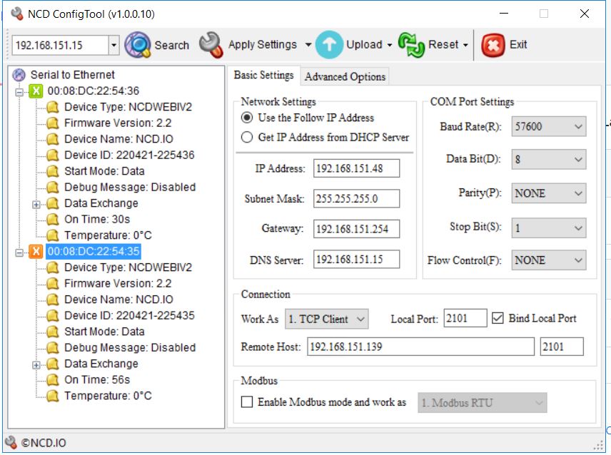

Have both units plugged in with static addresses. I can get in to both units and have setup one as the server and the other as the client. I can see in the interface that there is transmit and recieve packets. If we hit the button that is connected to one side we can see it switch like expected however on the other end nothing happens. What could be the issue and how should i trouble shoot further? I think i have the connection setup correctly.

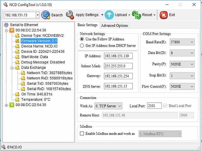

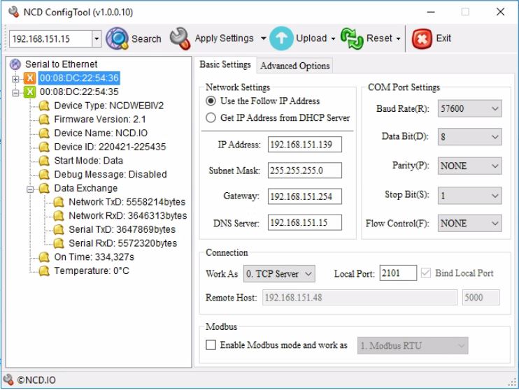

oops did not mean to post one twice. Attached is the correct capture. Yes the gateway is .254

I don’t see much other than the client board has the Bind Local Port option checked. You might try unchecking that. Otherwise everything looks fine. These are really simple devices. One acts as a TCP server and the other acts as a TCP client, so unless there is something between them preventing connectivity(firewalls perhaps) they should connect and work.
