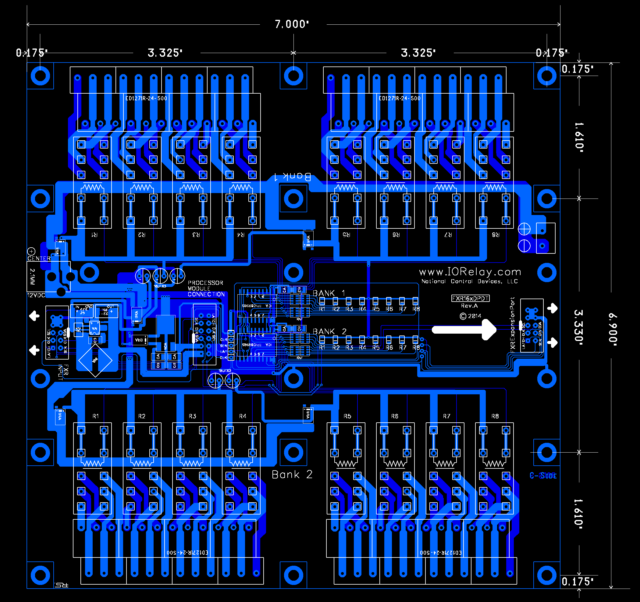

I am looking for any information on the height of the board/minimum clearance required for the
FLL_FXR161DPDT board as it might be in a system I am building

Maximum overall height will depend on the communication module installed. Do you know what communication module will be installed?
Hi Travis it would likely be an ethernet connection module
Overall height from bottom of lower PCB to top of Ethernet module(tallest point) is approximately 50.6mm
