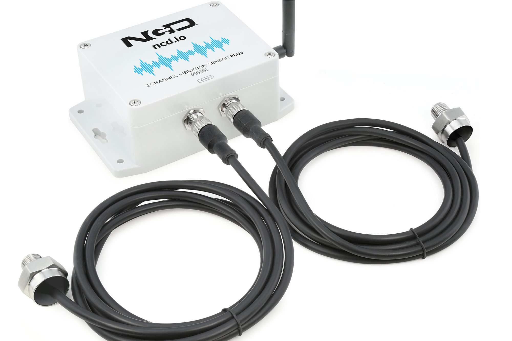

One suggestion though would be to look at this product if you are monitoring two points adjacent to each other:
