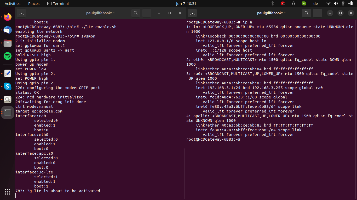

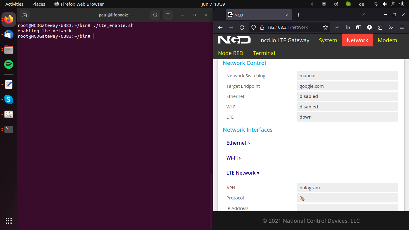

We are facing a persistent problem of activating the internet connection on the Industrial IoT Edge Computer Gateway, using the hologram IoT sim. When we try to activate the interface 3g-LTE, we continuously receive a message that it is telling that it is about to be activated but this process never ends with success.
In the attached files you will find some log files to better have a look at the problem.
