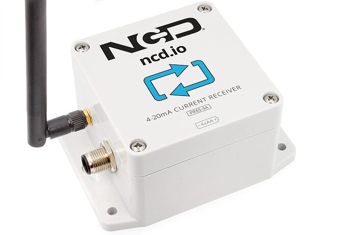

I am confused with this link:
It shows the M12 connector but does not explain in more detail how these wires CAN be used:
M12 Connector Connection
  1. VIN-
  2. VIN+
  3. 4-20mA+
  4. 4-20mA-
  5. DNC
So if I have a three wire 4-20mA sensor can I use this M12 connector from my Current Loop Receiver to power the sensor via the two power wires (wire 2 and 5) and feed the 4-20mA signal to the 4-20mA wire (wire 3)?
if you have 3 wire device you will need this transmitter
