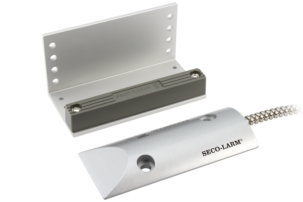

I don’t think an altimeter would be the best option for determining when the elevator is at the bottom floor. I would think something like a proximity sensor would be better. Something like this perhaps which generates a dry contact closure which could be connected to the ProXR A/D inputs:

I am trying to avoid any sensors placed in the elevator shaft. Elevator companies are very anal about doing that.
